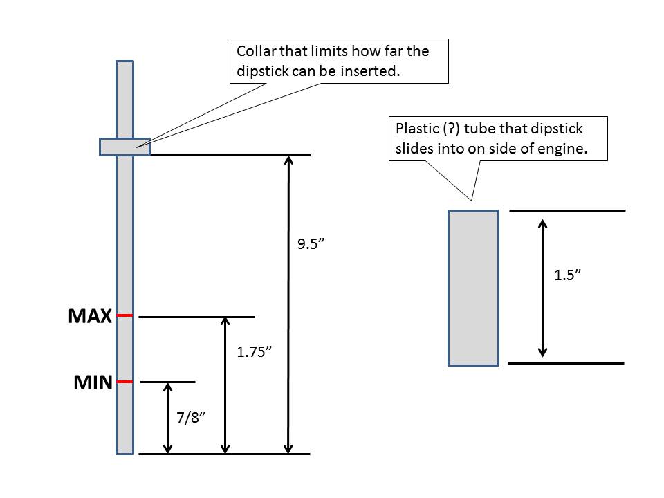

Now I'm wondering if I may have the wrong dipstick. I took the measurements shown in the attachment and I'd really appreciate it if someone could compare my measurements to theirs.

Ok. I measured my dipstick and I have a 1275 engine The 9.5" agrees. The min and max measurements agree also, but not at the words but at the two notches in the dipstick.

Thanks so much! At least I know the dipstick is correct. Any chance you can measure the length of that plastic (?) tube that the dipstick slides into? If mine were too short, that would cause the dipstick to go too far into the sump and explain the problem.

I did the best I could to measure the tube. First I am not sure if it is plastic or not. Eyeing my tape measure it measured less then 2", but I couldn't see well enough to see if it measured exactly 1.5", but is close to it. Above you you say 6 pints and then say 2 quarts. Doesn't 6 pints equal 3 quarts. Maybe you put to much oil in it. I will look in my books to see if I can find hpw much oil is correct.

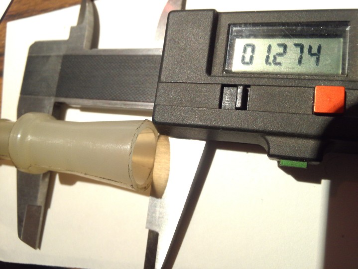

I have 3 plastic dipstick tubes here. 2 are original (one from a 1098, the other from a 1275), and one is a Moss replacement. They all measure 1.275" (+ - .005) for the part that remains external.

Thanks, Gerard. That's probably the same as the one in my 1275. My measurement of 1.5" was not done as accurately as yours since I couldn't remove mine and I was using a tape measure.
