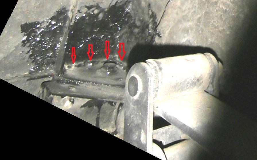

    I also suffered with the "clunks" in my 3A. Passenger side, rear. I attacked the shock with Stover nuts (didn't know they had a name) and "TORX" head bolts. No help. Hard to re-create a clunk while up on blocks in the garage, but I gave it a try. AND FOUND IT !!! (see photo) The rear apron assembly has a corner piece just behind the spring eye to accommodate a frame mounting bolt. It had ruptured (probably rust) but I never noticed it during my frame off some 20 years ago. The bright area around the corner area is several coats of paint after my friend TIG welded it back together.
    Frank
    Attached Images Attached Images

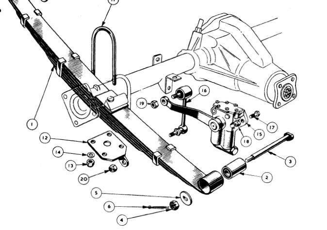

    I have a related question about the horizontal mounting plate under the spring where the shock lever is attached. While under the car adjusting the end float I thought I might just check the 4 nyloc nuts securing the U-bolts to the plate. They weren't really "that" tight so I thought it best to see if there was a torque spec for them. Sure enough, the nuts on the "clip" (U-bolt) securing the "road spring to rear axle" take 28-30 lb/ft.
    My question has to do with the best technique for torquing these nuts. Given the architecture of the U-bolt it seems that it might be a bit tricky to get both sides snugged down evenly without putting undue stress on the "U" on the top. Any suggestions on a good approach to tightening these nuts evenly to the correct torque?
    I just run them up in stages, working corner to corner and keeping the plate more or less flat to the spring. Don't even use a torque wrench, just guess at it. No problems so far.
