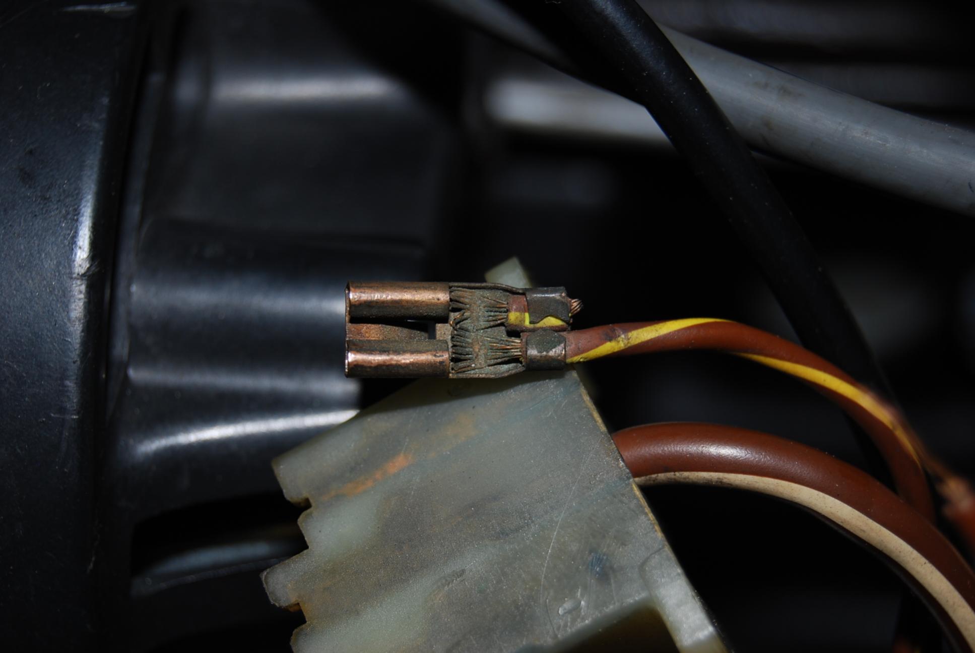

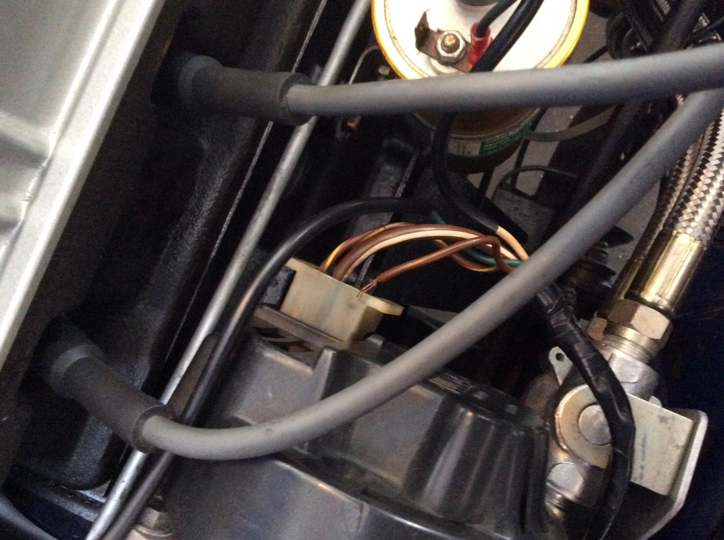

I just got done putting the engine back in the 72 TR6. When we starting hooking everything back up I noticed a brown wire without connection. I assume it came out of the block for the alternator but can't swear to it. The wire is constantly hot. The car seems to run fine and all the electrics appear to be working. There doesn't seem to be any place in the electrical block to fit the wire. IE: no spades or missing connectors. The wiring diagram is unhelpful to show what is actually wired in there.
Any ideas?
Thanks,
Joe B

I have no clue if that wire feeds there or not. That wire feeds into the main wiring loom that runs into the DS fire wall. There is a brown wire that comes out of the main loom (same spot) that feeds into the fuse box.

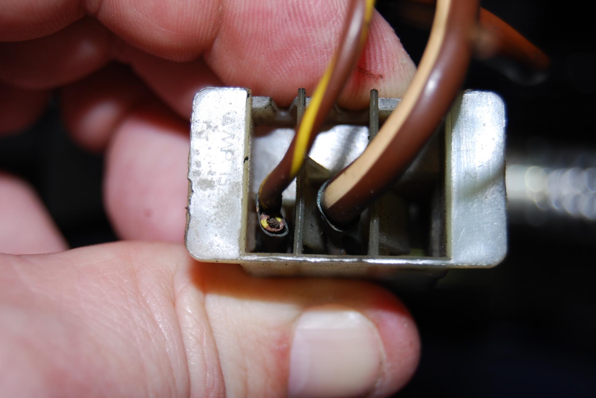

If you look at the pictures below you can see only two wires currently connected to the alternator. One brown/yellow and a fat brown/white wire. In the second picture you can see where a brown/yellow wire has been cut off on the smaller connector. BTW, the second larger opening in the block does not have a connector in the block. There is a spade on the alternator however. The only other wires coming out of the harness in that spot are for the water temp sender, the oil pressure and the coil.

What I see in the picture is a small brown wire which appears disconnected at the alternator plug. Is that the one that is hot all the time and you aren't sure where it goes?
That appears to be the later Lucas 3 wire alternator, not the earlier 5 wire type. The small brown/yellow wire is for the indicator lamp and the big brown wire is obviously the output which will be connected to a terminal on the starter solenoid (after passing through the ammeter if your car has one).
The remaining alternator terminal should be for the sense wire. I suspect that there is currently no wire on the remaining terminal in the alternator plug and your small brown wire just needs to connect to that open spot.

The last set of pictures you posted look to me like a conversion has been carried out to use the 3-wire alternator where the 5-wire was originally used. That cut-off brown/yellow would have gone to the second connector used on 5-wire alternators. Your statement that there is a terminal with nothing connected makes me believe this even more. As I said in the last post, it looks like the small brown wire is for the alternator's sense terminal and would fit that open slot in the connector plug.

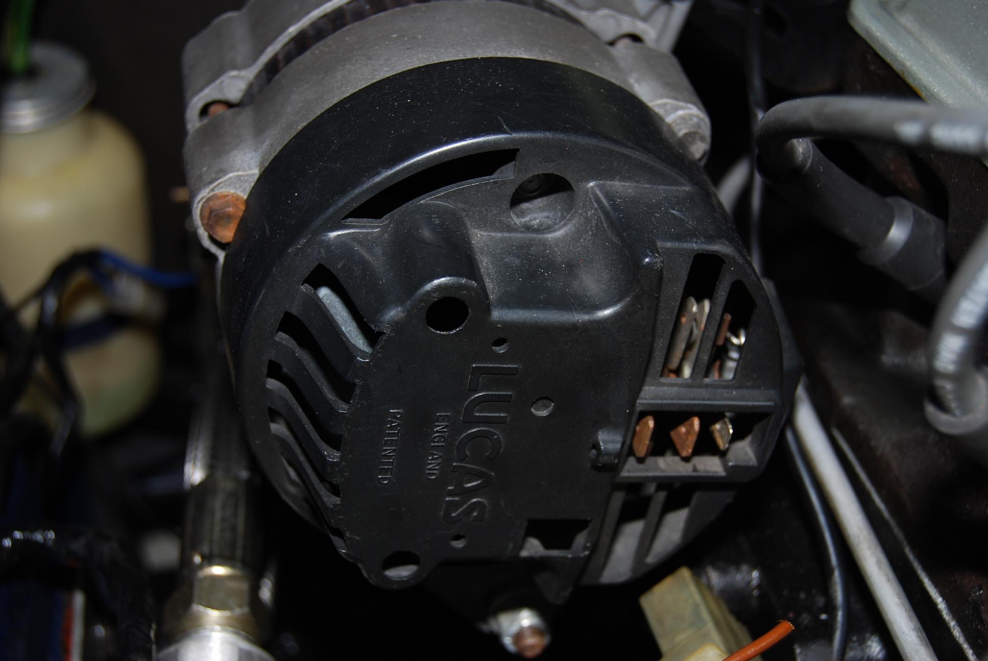

Well to be honest I have no clue. I bought the car like this back in 96, so it is possible it was swapped out with a later alternator. The strange thing is there is not a spade stuck on the end of the third alternator terminal. Nor do I see where that little brown wire could have been connected to on the large n/w wire terminal. I also just started unwrapping the harness to see if there were two wires cut and still in the harness. I took it down about an inch but didn't see anything. So, anyone have a picture of a three wire alternator setup?!
Attached is a picture of the alternator in my car (wish I could find a part number on it).

Stick with the 3-wire alternator you have. They are much more common than the 5-wire so when/if you ever need a replacement you will find many available.
The sense wire just goes back to the battery (really to the solenoid), that's why that disconnected wire is "hot" all the time.
I suggest a read over the Moss article in the link below. It says basically to tape off that extra brown wire.
