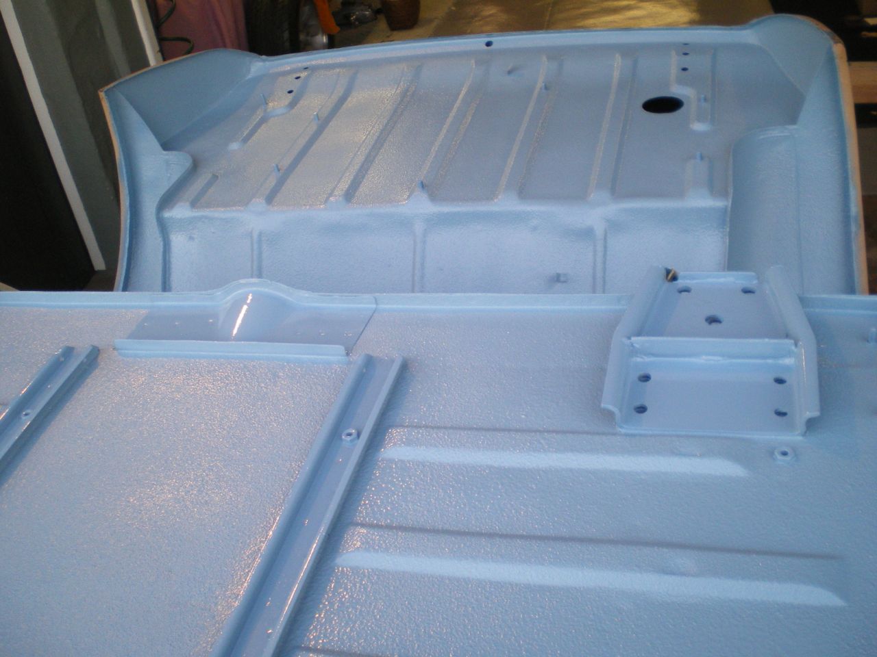

Yes around the spring mounts is a problem area but I'm talking about the hole in the boot that gets filled up with dirt and bits that you thought you must have left somewhere else. Namely the pocket directly behind the rear wheel's where the outer fender is spot welded to a panel that drops down from the floor of the boot. To get at it you have to crawl in and reach over the bracing on each side. My car is a rust free California car but I got some scaley rust colored stuff out of those holes, along with pens,bolts and nuts. Vacuumed out and wax oiled.
Kurt.
Gerard
Kurt.
The pocket Kurt is referencing is formed by the shut panel between the boot floor and the outer fender. You can see it clearly in the attached photo. It was the only spot there was any rust on my current Bugeye project, so a new one was made and replaced. You won't be able to see much back inside the boot, so check it from the underside as well.
You'll see mine has been seam sealed and undercoated, so it should never be an issue in the future, even if I ever do get it on the road... :playful:
