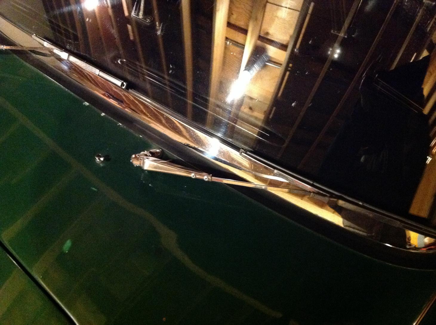

    Hi Dougie
    seeing your interesting video I have noted that your wiper works in very good manner
    on my 57 100 SIX MM the wiper rackets (new AHsparesWSN152-153-and 2x159 )woks very nearest the top limit-
    the first time that I activate it the rubber blades was stopped by the top end (and also from upper Hard Top aluminium profile) and wiper action is stopped with serious risk to damage the electric motor or gears
    The only remedy is, exit from the car, also with heavy rain, an pull down (0.5/0.7 cm)the rubber blades.
    the wiper arm and blades appear have the correct dimensions-
    arms appear to be in the correct position,
    is possible that I have reversed the blades? I have supposed that blades haven't a one way 019.jpg
    Cheers

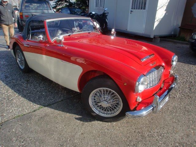

    Hello Andrea,
    Judging from your photo...it looks like your wiper arms are positioned to high in the off postion. The wiper blades should be resting on the lower chrome windshield trim in off postion...not above the chrome windshield trim. Just reposition the wiper arms lower. Also, you may try to take off the wiper blade arms and switch them around. If that doesn't work, then I would suspect you have the wrong size wiper blades.Note the attached photo.Take care!
    Attached Images Attached Images
