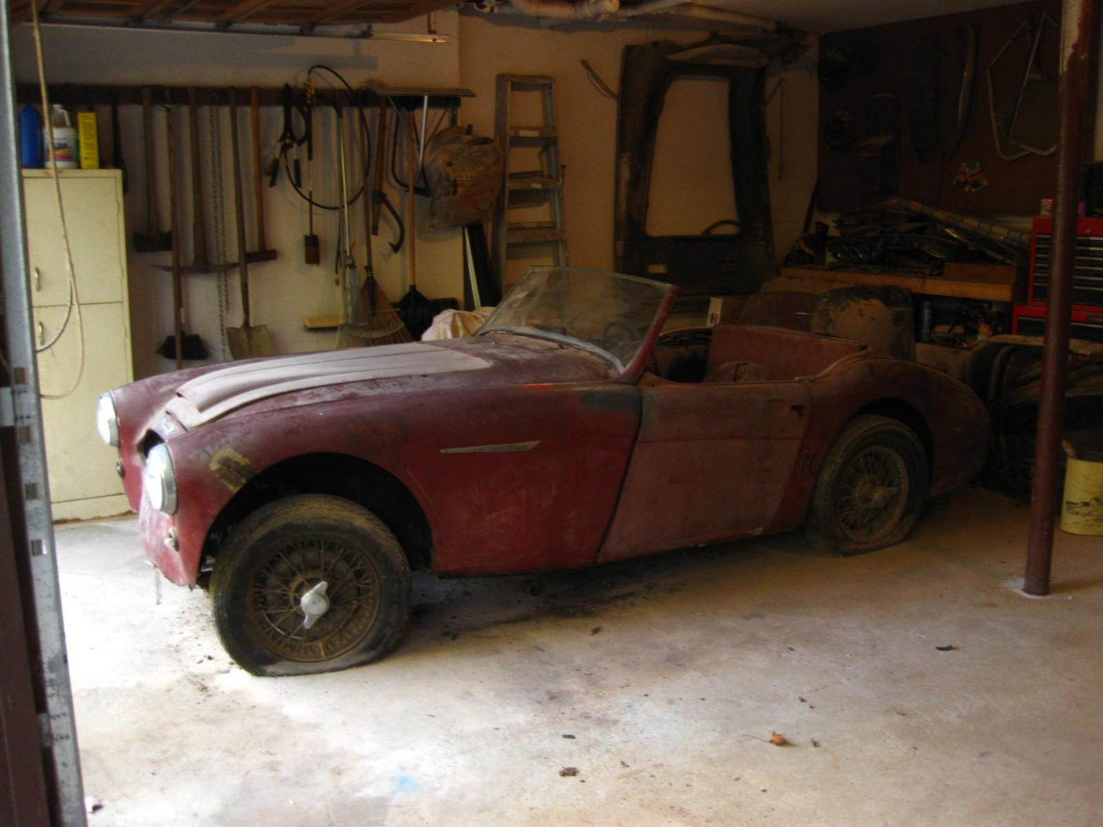

Anyone know the actual color or color code for a 1956 100-6 frame. It looks like a green metallic, but I would like to get an exact match. I am just beginning a ground up resto and want things right.

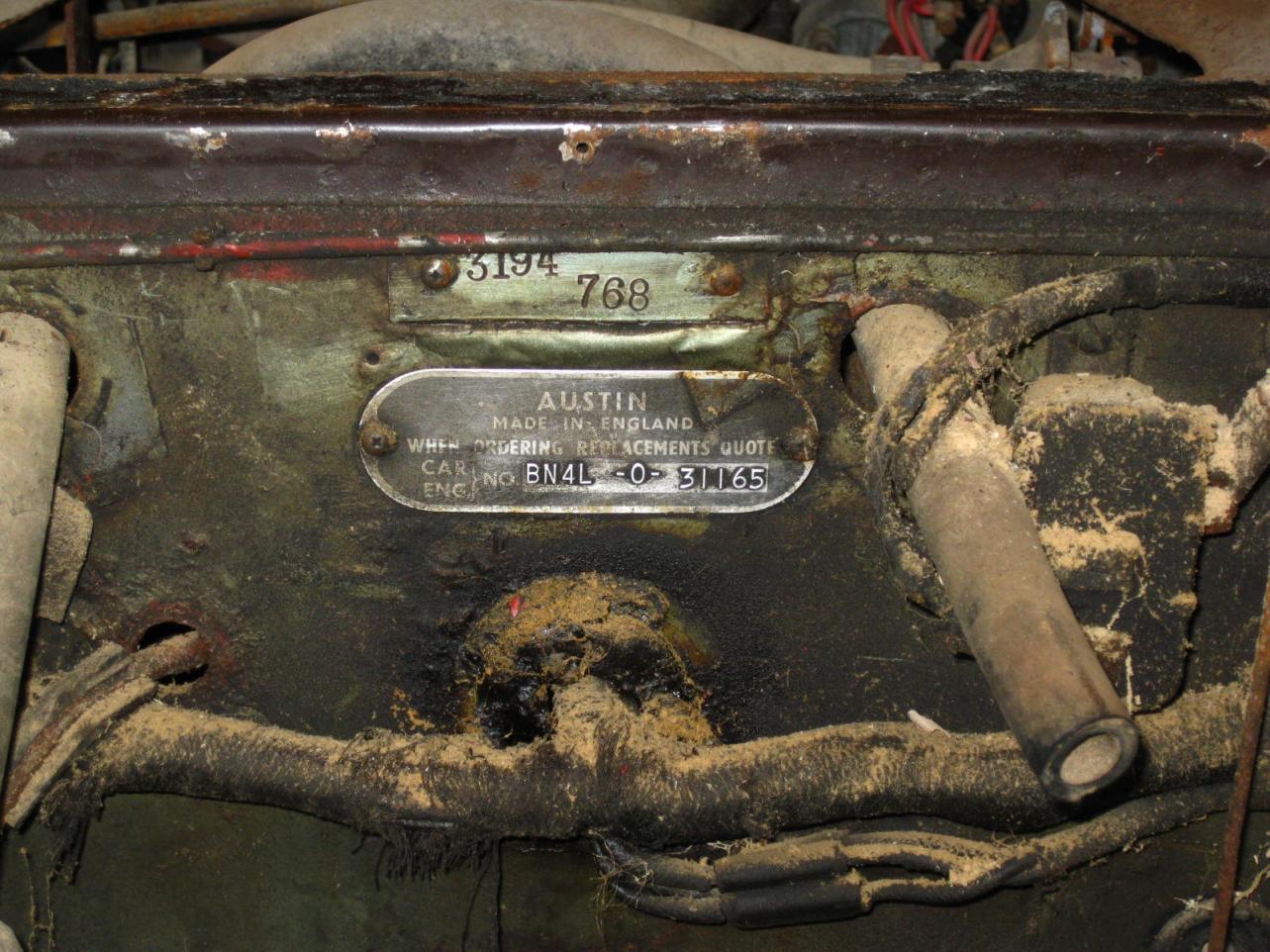

Jep - I am sorry, but I failed to ask, what is the body # of this early 1956 100 Six? Best of Luck with the restoration jim:driving:

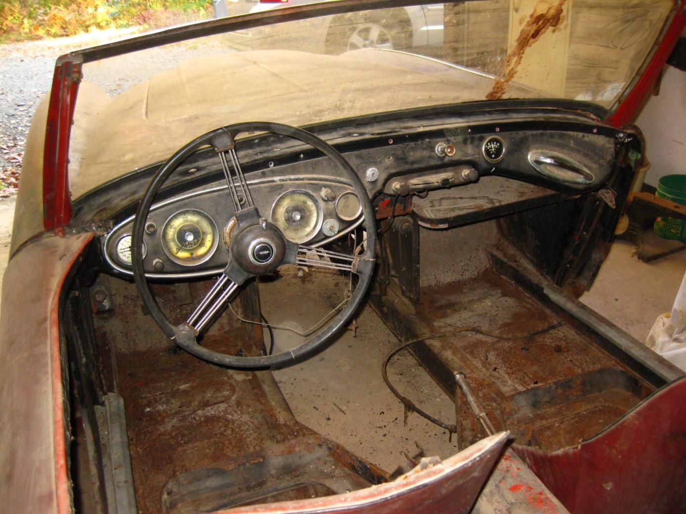

The info I got on the green frames was from research done on line and could be wrong. I haven't got the Heritage cert yet so am not totally positive of the final color, but based on what I see when everything was stripped such as behind the heater and way under the dash (parts that have to my knowledge never been off ) the orig color was red. I do know that with the frame down to the weldment, that color is the same, or almost the same as the engine. I have owned the car since 1969/70 and took it off the road in 71. It's been waiting me ever since! The car no. Is 31165, body no is 3194/768. I appreciate all the help and advice, thanks.

No, the plate identifies it as BN4L-O-31165, I'm in a puzzle over this as the inside of the chassis behind the heater and way under the dash where one could assume no work was ever done, the car hasn't been previously rest., is red. Still, with the car stripped to the frame it's a metallic green. To paint this area without taking the car apart would have been impossible. Thanks for the input

Jep - thanks for the input, with a body # of 768, it is truly an early Longbridge. Could you happen to be able to check the radiator for a rectangular build date tag of 3 or 4 digits 56x or 56xx located near the top of the radiator either in front or back. again thanks for the information. jim:driving:

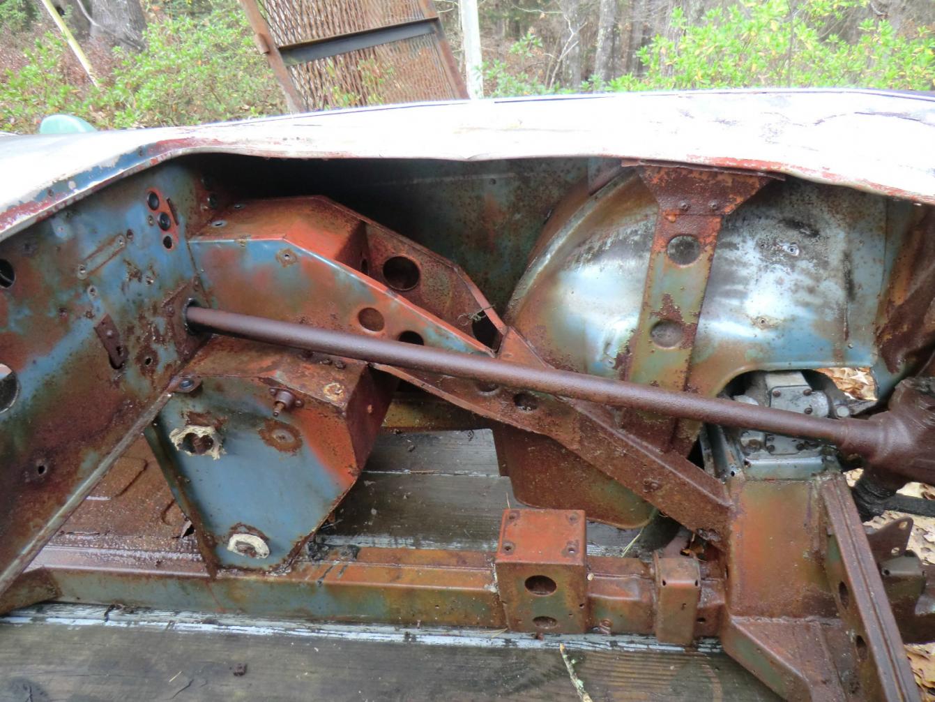

All pics I have of production-line cars show they were painted dark chocolate brown (same as the transmission tunnel and seat bases), then red oxide primer, then color.
This is an unrestored/unrestorable 57 BN4 showing how casual the original paint coverage was.

Hi Andy, thanks for the input. The casting has AEC666 on it. Since I got started with this forum I have gotten a lot of info but then even more questions. I will try to post some pics when I figure out how. I haven't yet stripped the paint from the body panels, but after all the comments, I carefully sanded off the top layers of red paint, and underneath I found a light metallic bluesy green just like the frame. I tried matching this color to the std 1956/57 colors but nothing matches!! Still inside the passenger compartment everything is red???? I've sent away for the heritage info, so I guess I will have to wait.

Jep - getting back to your radiator with the tag 575. Does the radiator have a # 11B 2301, next to the filler cap? if this is the case it would seem that this radiator is actually a replacement, since the correct radiator for this early Longbridge would be radiator # 11B 2298, but this number was not stamped anywhere on the radiator. thanks for checking and yes share photos when you get a chance jim:driving:
