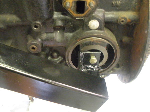

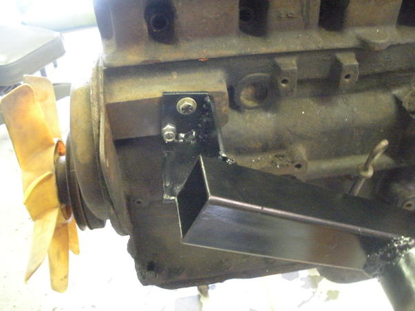

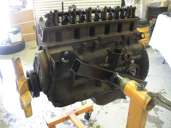

I have a GT6 engine to build, actually a a GT6 vintage race engine. Now I've long had side engine stand adapters for the MG A, and B series engines and even the Spitfire 4 cylinders, but I never made one for the the Triumph 6 cylinder, so I did last Saturday. I've been spoiled by side engine stand adapters because the let me mount the rear back engine plate, flywheel, and clutch while the engine is on the stand, and also face the rear, or front of the engine upward, making it easier to work on them. her's a pic of my new 6 cylinder side adapter.

I wish I had done that a couple of years ago. Life would have been better with a side mount.
DNK
Personally I think Hap needs some work on his camera skills.
How about a couple of other views of it?
70herald
Nice stand. I wish I had something like it when I built the heralds engine.

Dang that is nice Hap- Wish I had that flexibility with the TR3/4 blocks but I can't think of good mounting points on those engines.

Well, we disassembled the GT6 engine yesterday, we were hoping for unmolested and that's for the most part is what we found. Everything is standard, as for the crank and bores, looks like someone replaced the rod bearing at one point, they were glacier bi metals, and checked the mains, but left them in, they were still Vandervell VP2s. The cranks looks good, and is standard, but it will need to be ground to .010"/.010". Next step is degreasing and getting all cleaned, then on to ordering some parts and beginning the machining phase. Right now getting the race cam I want, and prepped to the level I want it, and getting the block line bored for cam bearings are tow big projects. I got to figure out what to do as for the piston I know they will be custom JE, I would prefer to us a flat top, if can get to 12.0 to 1, i have to go over the math to see if that can be done, for sure the GT6 head has smaller combustion chamber when compared to the 1500, or TR6, so maybe the flat top pistons will work.
The engine stand was extremely well centered with the head removed, and we could rotate the block quite easily, I lucked out there :smile:
