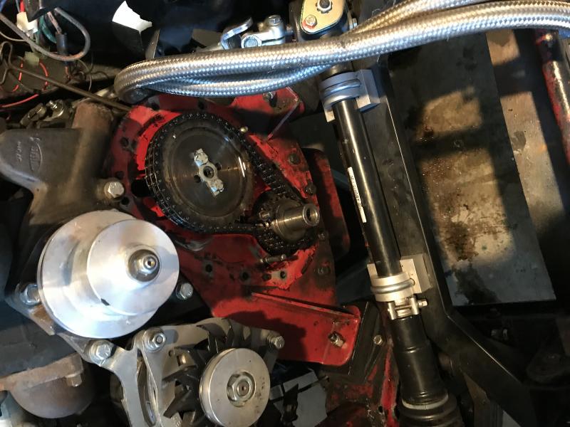

Not again. There is that rattling inside the timing chain cover and I know what it is. The tensioner is broken...again. Third time. What the heck. Anyone have a solution. This time, after I remove the bumper, front apron, radiator, fan and all the other little crap, should I just leave it off? What is everyone else doing about this poorly designed and flimsy part?

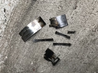

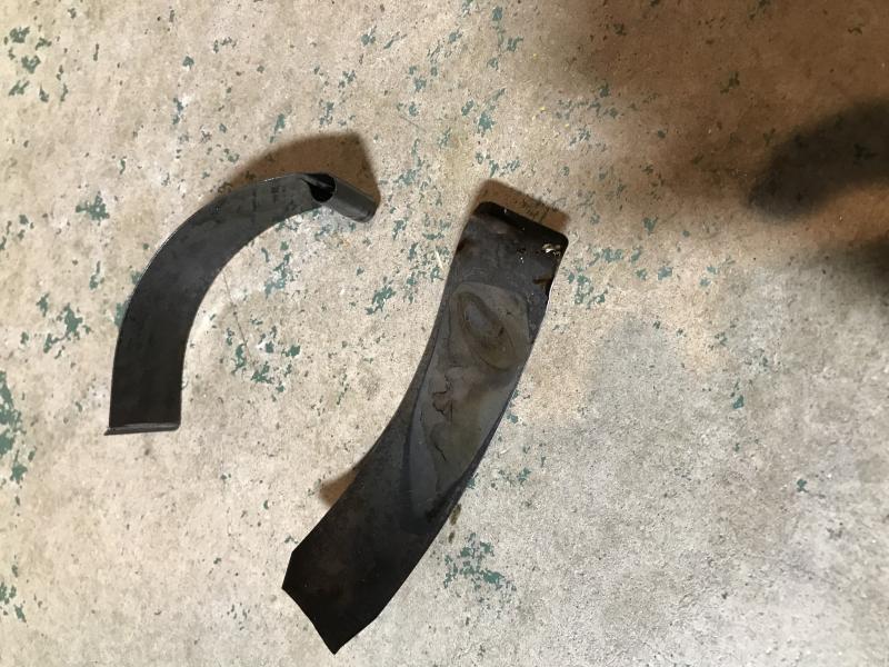

Purchased from Moss, but probably made somewhere west of Japan. It is just like the pic above. Breaks at the bend and then rattles around. One time the chain drove it through the cover...found a "new" one on Ebay.
This time it is approx 500 miles after complete engine rebuild. It would be foolish to follow the same path of replacement since that path has not led to success.

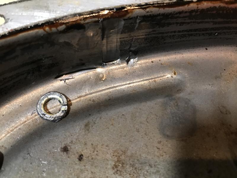

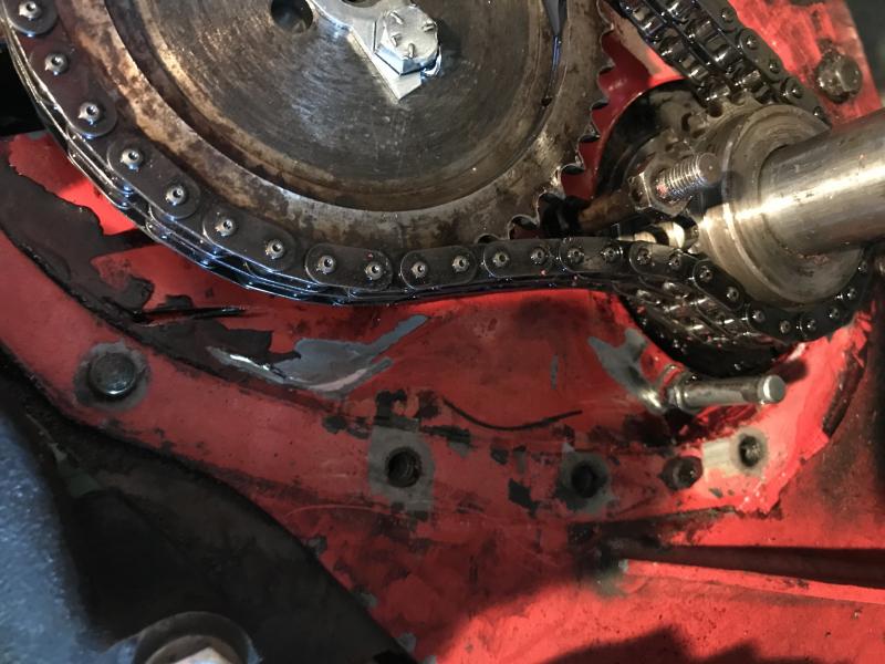

I suggest that when you get it apart to look at the pin that holds thetensioner and make sure it is true and to also look and see if the bear plateis flat. I filled the last bear plate with weld and ground it flat where the tensionerhad cut a ditch because I felt the ditch was causing things to bind , but I guessyou can also purchase a plate new.

Good idea on the plate. I'd have to pull the engine to do that if it is the case, however. I think I would have noticed if was not flat, but maybe not. The pin is new (I've replaced it each time as well).
One thing I note is that running without the tensioner, is no reduction in performance. I suspect maximum a couple of degrees of timing off during deceleration and I don't notice that. I suppose the purpose of the tensioner is to keep the chain and cogs from wearing when power load is removed and/or applied. Frankly, with what I have been having to do I am tempted to run without the tensioner and pay the piper later with new gears and chain. Does this sound insane?

Here is my experiment. I ordered tensioners from Moss and TRF. I will let you know if there is a detectable difference in the quality and/or supplier. If they are the same, I will run naked without the tensioner. If TRF's looks better, I'll give it a shot. For obvious reasons I won't run the Moss one (though many other transactions with them have been more than satisfactory - I have no axe to grind).
I will also report with links to pics if anything of importance is visually apparent.

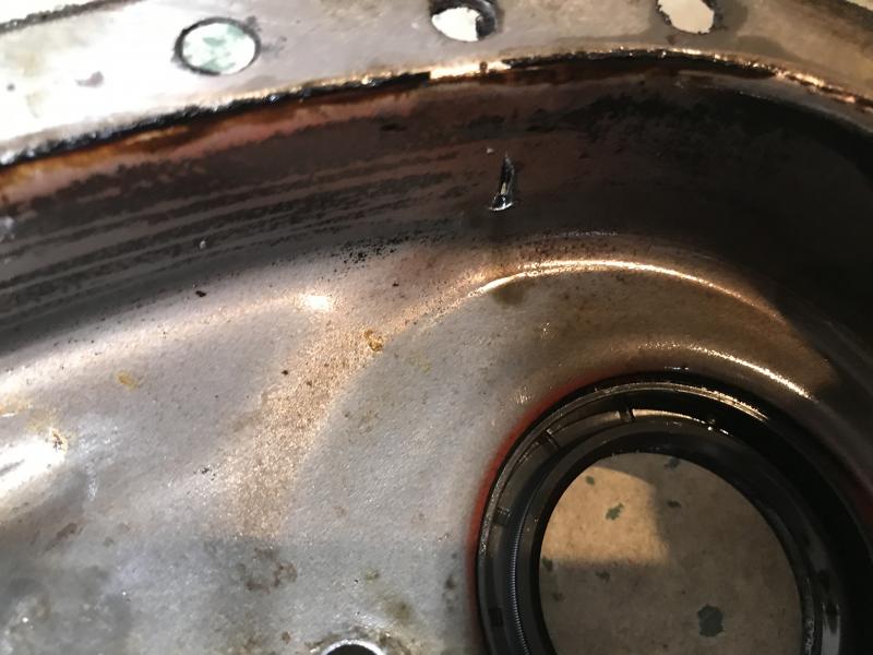

Tempting, but I wouldn't do it. A new chain is very snug, but over the miles it slowly stretches from pin wear and metal creep. The result is that eventually the chain will start rubbing through the cover. Now, it'll work to run without if you plan to change the chain every 10-15k miles. I guess that's a lot less frequently than you're doing now, though!?!

Rubbing through the cover. Dang. I hadn't thought of that. When I have it apart I'll look at that possibility. That would be no good since covers are hard to find. I'll post here results.

I've seen chain drives run at speed without a snubber. There is always at least one rpm where the slack part of the chain starts to whip around wildly. That can't be good for long life of either the chain or the components it is attached to.
