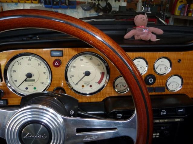

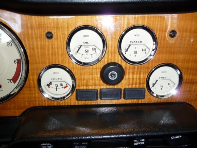

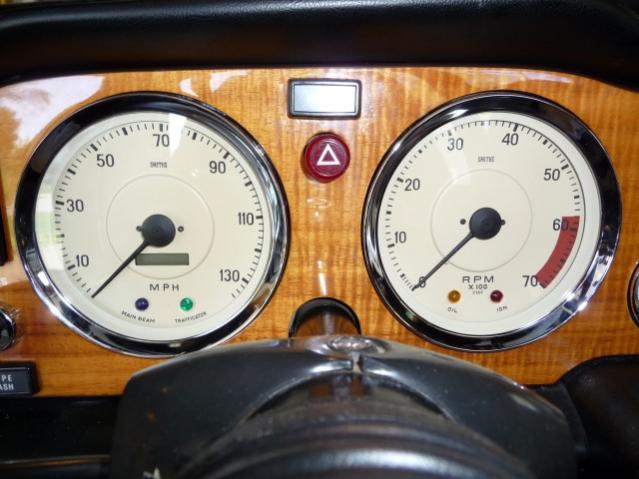

It's been a long winter and I finally got my new Magnolia gauges with the tach converted to electronic and the speedo to GPS......... all quality work done by Morris at West Valley Instruments. I was going to send all the gauges to be refurbished and painted Magnolia but it was actually more cost effective to buy four new small gauges already with the Magnolia face.......... the best part was they only came in the early needle down style which I've always liked better then the later needle up style. The tach was converted to electronic and the speedo has the face of Smith and the GPS guts of VDO. The only tip off to it being GPS powered is the LED readout for the odometer. With the sensor/antennae "hot wired", satellite acquisition is instant......... the speedo actually registers my speed as I'm backing out of the garage! Morris is also working on some other variations for an electronic speedo so GPS isn't your only options for a cable-less speedo. I love how both the needles on both instruments are super smooth and accurate. Obviously a conversion that isn't for everyone and definitely not for the concours/originality gang but four guys in 6-Pack have now placed their orders already.
