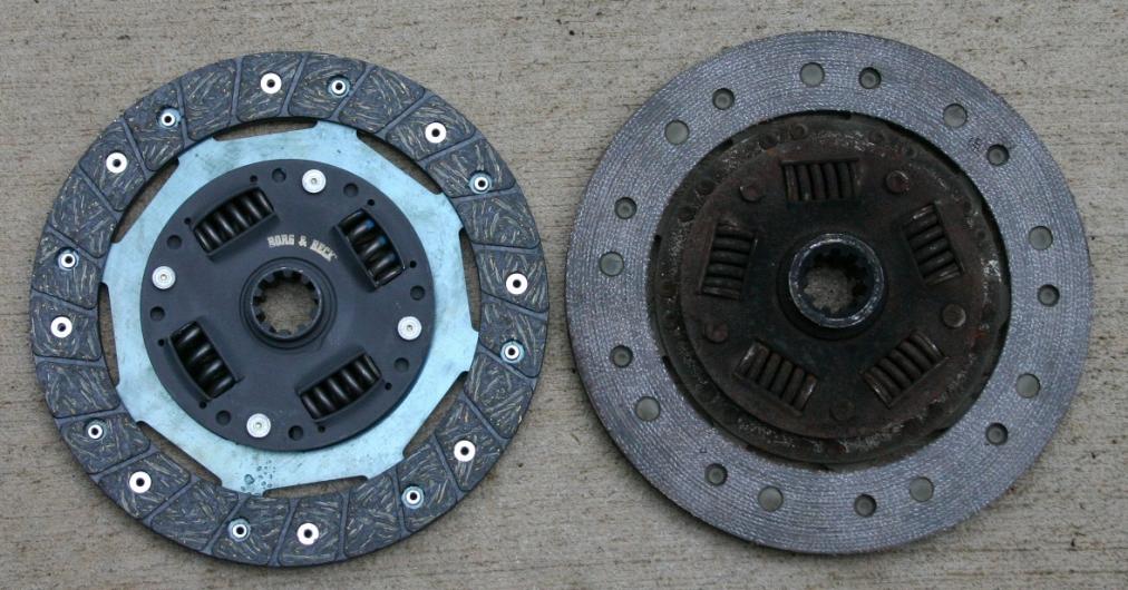

I'm interested in members' opinions on this because I'm facing the same issue. When I reacquired my bugeye after 38 years a 1098 had been installed by the prior owner. The smooth case transmission had blown - maybe 25 or 30 years ago - and the car was pushed in the corner. I'm working on the body and haven't done anything to the engine except confirm it has the 295 head and is a 10cc. When I picked up a ribcase transmission from the local British rebuilder/restorer he said "put a 1275 in it; it'll cost the same to rebuild".
By then I had already bought a 1098 clutch on the internet. Now you guys are scaring me to death with the 1098's torque. Here is a picture showing the new disc compared to the old. There's much less grip surface. It's also a 4 spring. I checked the B&B numbers and there are several UK sites listing this as correct for the spridget. When finished the car will probably spend most of its time going to the hardware store and back.
Is this clutch OK for the stock 1098?
Thanks, Jim
I ran into the same dilemma when I purchased exactly the same disc.
Torque transmission has to do with the disc compression force times the friction coefficient. Nothing there about surface area. With the smaller surface area, (assuming the same pressure plate) the specific loading will be higher, and the disc might wear out sooner, but here I suspect the material is different and may last longer than the old unit. Therefore the smaller area, and I would suspect it will work just the same.
Actually I'm putting that unit behind a 1275. It has a larger diameter than the 1275 clutch, though not a diaphragm pressure plate, and I like the feel of the spring type pressure plate.
Thanks, Jim
Jim,
You are correct about the new clutch discs having less surface area. The old ones are about 1" wide and the new ones about .9" If it's a complete kit, you should be OK. From what I've been able to find out, the new matching pressure plates have more clamping force. I would strongly recommend against putting a new disc with an old pressure plate; here's why...
Last year, I had someone that didn't want to spring for a complete new clutch kit. Instead, he brought me a new friction disc he bought and asked me to install it while I had the engine out. Upon driving the car for the first time with the new disc, the clutch slipped as bad as one completely worn out. I don't think he made it more than a mile. I bought a new B&B clutch kit, installed it and it worked fine as a complete kit. His savings over buying a complete kit were spent 5 times over having to pay labor to do it all over again.
