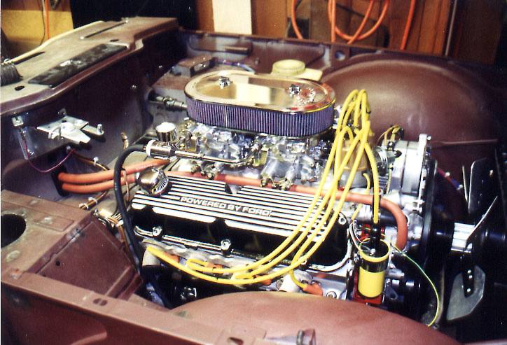

Dan, I think your in the right place to talk about power imporvements. Dick Taylor told me about a ride in a V8 TR6. I would venture to guess that alot of people are waiting for the results of your project, I know I am.
danmas
Mitch, there are several TR6s with V8 engines in them, ranging from the 215ci BOP/Rover aluminum engines up to a 350ci Chevy. I have had the pleasure of driving some of them, and they are a blast - everything we love about the TR6 and much more.
I'd like to invite you - and everyone else - to attend the British V8 2005 meet in Terre Haute, IN june 9 - 12. See https://www.britishv8.org/Events/2005V8MeetFlyer.htm for details.
Even though the meet is called "V8" your supercharged TR6 will be more than welcome, and there will be a great deal of interest in it by the V8 folks. There is no competition or jealousy amongst this group, just a bunch of gear heads gathering around to talk about how to make these cars go faster. I think you'll enjoy yourself at one of these events more than you will at any other Triumph meet. Now if we could just get Dick to attend!

Besides the V8 engine and transmission conversion:
(it is heavier than the original powerplant)
Power steering
LSD (2.93 ratio)
Geo Tracker cloth bucket seats
Tube Air shocks in rear
Coil-over shocks in front
50 light LED light bar under rollbar
Air horns
1/2 inch thick steel safety tunnel over driveshaft
Center console from toyota
whew!
fun, fun, fun....

Dan,
I visit your site on a regular basis just to drool. The dash does look very cool. You know if you use your wiring harness you'll get board not having to trace bad grounds /ubbthreads/images/graemlins/grin.gif.
The V8 meeting in June looks very tempting. I'll have to check & see if my ass is up to it /ubbthreads/images/graemlins/wink.gif, I love to drive my car but I gotta think about it.
