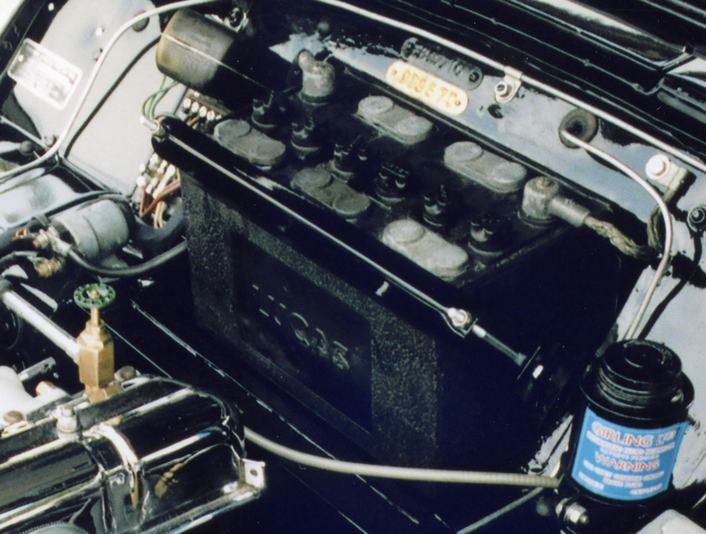

I still use the four original black rubber pads that came with my 1958 TR3A when I bought it brand new. The pads measure about 2.5" by 6" and you stack them two high off center under the battery. I think they help let the water drain out the battery box after a heavy rainstorm or after you have washed the TR and water collects in the bottom of the battery box, These pads are non absorbing and allow the water to drain out the bottom hole.

Thanks gentlemen. I hadn't even thought about the rubber spacers.
Don - about how thick is each of those four pads? I may just use several pieces cut from old inner tube.

Hey Tom,
They are a bit thicker than that, like 1/4". That would be a lot of layers of inner tube.
