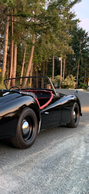

IMHO... the perfect size tire for a TR3 is a 195/65/15. I run TR6 wheels with 0 offset. No rubbing... fills up the wheel well perfectly.
