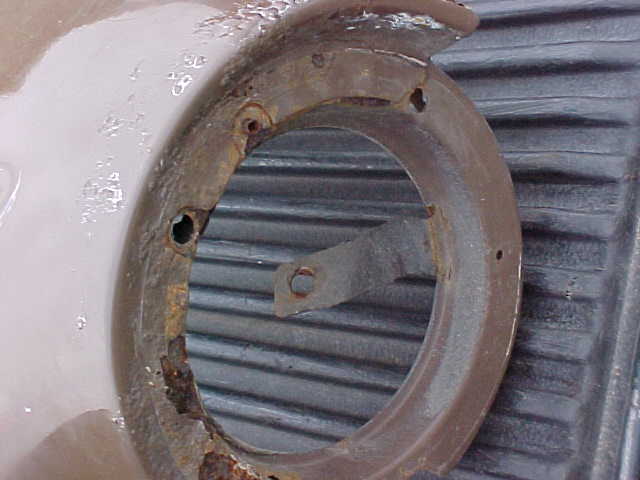

Wayne,
Is this the weld that you are speaking of???
This strap is welded to the front wing, but it is bolted to the inner fender on the other end. The threaded end of the upper bolt for the bonnet hinge protrudes about an inch past the keeper nut. This bolt is then used as a stud to attach the strap to the inner fender. Without this attachment, the inner portion of the front wing is not supported properly.

BOXoROCKS
trrstr2000 is right, except it is a spot of braze in the seam between the fender and the f valance, not on all but some. Also on the rear fender at the rocker in the joint,mostly on the pass side, not all but some. Hey, this was a production car, and a triumph to boot.

Yellowdag, the one's I have done were both early model and at the very top of the wing where it comes apart and one even had it on the bottom of the same seam. These may have been done by someone else but neither wing had the bracing bar you show. If I ever do another one I sure will be on the lookout for it, but then again it may have been on the ones I did, been about 7 years since I did a TR6. Thanks, Wayne
Ok, went back and checked mine as it was the last one I did and sure enough it has the straps attacked to one of the bolts
/ubbthreads/images/graemlins/cryin.gif on the hood hinge, old age is heck. Wayne
