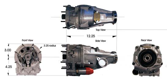

Hey Dave, while you have the J-type out of the car, would it be possible for you to take some photos and measurements for me? I was at the PRI trade show last Saturday with a couple other TVR owners and we saw what appears to be an updated Laycock overdrive that they rate at 1200hp.
I don't have a J-type of my own to take measurements of, or a D-type for that matter (just in case someone wants to take D-type measurements & photos).
