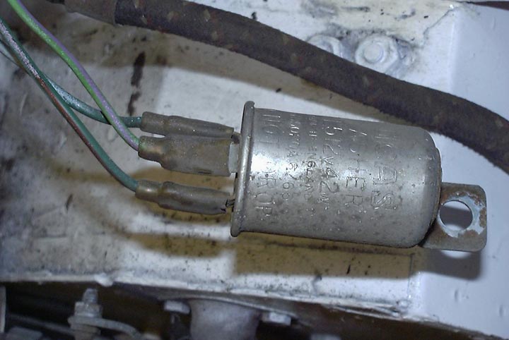

It sounds like you have two wires hooked up wrong on your flasher. Here is a photo of mine.

Thanks for the advice and the picture, unfortunately, mine is wired identically to yours except that the flasher unit is labelled L P and X rather than B. It's got to be something wrong with the return connector or maybe the flasher unit is faulty, I'll try to lay my hands on another flasher to see if that makes any difference.
