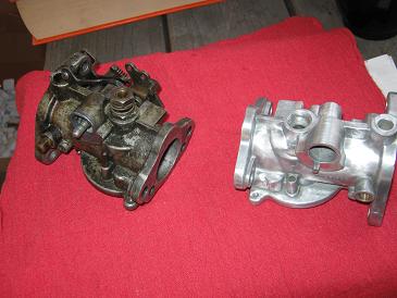

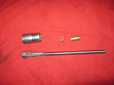

Found a great article at the Chicago Land MG club web site on how to line ream throttle shaft bushings. The article is by Anne & Jake Snyder and provides all the details. I did the job this past weekend in about an hour and cost me $15 including the shipping cost for the reamer. Bought all the stuff from McMaster Carr. The key is the shank OD on the reamer is the same as the bearing ID. This keep everything in line as you ream out the old bushings. I used my variable speed hand drill to speed up the process and then lapped the new throttle shafts to match the new installed bushings. I did coat the outside of the bushings with high strength thread lock prior to installing. I used the 3/4" bushings and trimmed the inside bushing flush to the carb body. Also used JB Weld to attach the nut to the front of the reamer as my driver. I've attached some pixs on the set up, but the article details the process. The good news is after the rebuild, the car started up on the 1st try, just need to dial em' in today.

The wobble is not a good thing but the shank should provide plenty of stability as it runs through the opposite (guide) bushing. Looking from the nut end toward the shank, I cut a 30 deg angle on each blade. I took it to my bench grinder and had at it!! Initially I was cutting by hand, but then hooked up the hand drill and it went very quickly. To get the final fit between the new bushing and the new throttle shaft I chucked the throttle shaft into my drill and ran it in and out of the bushings several times. That got the final clearance and a really nice fit.
I have to admit reaming the 1st bushing caused some "pucker" but I'm naive enough to keep going. Fortunately it had a happy ending. Just finished fine tuning the carbs and there is a major difference.
Note.....don't ream completely through the carb body. You should leave some material to seat the bushing into the carb body.
Good luck and keep at it!

Love what you've done with your carbs!! I am about to embark on a carb project myself.(hif4 to Hs4 conversion)
They look like the carb on the left now and I need to know how to clean the body's and float bowls so they gleam like yours :yesnod:.
I think I may get lucky on the shafts as there is just barely any slop now and I took 1 out and there is slight indentations in the brass so I'm hoping just the new standard sized shafts that come in the rebuild kit will be enough....I can always order some OS shafts if there is still some slop i guess and I have a buddy who is a machinist so getting them line reamed if I need to won't be a problem. I want them to Gleam though and standard carb cleaner and Lacquer thinner just don't cut it.
I have a buffing wheel on my grinder and some different rouges etc but is there an aluminium cleaner that takes the black out of the metal before you buff?

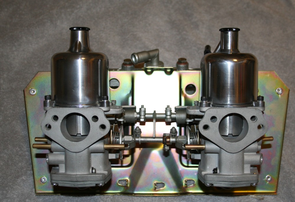

I do my rebuilds with a glass beaded carb body, float chamber and lid, the hand and chemically clean the piston dashpot, then polish the outer portion of the dashpot with a buffing wheel. Here's an example.
Bill sorry I see this in time, give me call, reaming your carb body will take about 5 minute tops.

I'm a hand polishnig guy. Start w/ a good cleaning and brushing and do my polishing w/ a dremmel and finish w/ steel wool. Not the most efficient way, but works for me and produces a nice result.
ps I'm retired so time is a luxury I can afford........
