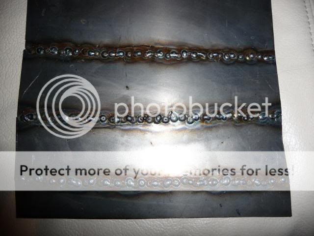

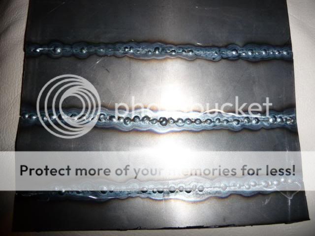

Disclaimer....I am not a body guy and have previously farmed out the small amounts of metal work that were required on my TR6 resto. I have decided that I want to do this work myself and have purchased a MIG welder and have been learning how to weld by practicing on scrap/reading and watching videos etc. I am pretty confident that I can do the work.
