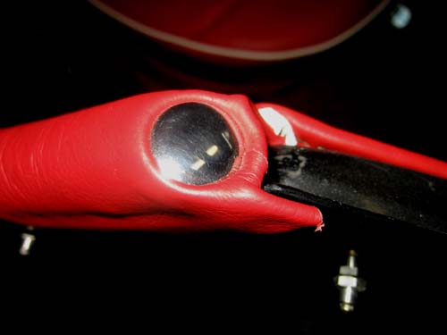

Also, it's possible to cover the end cap <span style="font-weight: bold">without</span> adding another piece on. I did it with mine. You will have one seam, but that seems unavoidable. I just left a generous section of leather to work the end caps and carefully shaped it around, cutting and lining up where the seam would be. It's a bit tedious, but it can be done. I don;t know if it's possible to do without any seam, but if someone has a way, please share.
Here's the end result <span style="font-weight: bold">without</span> a section added in.
