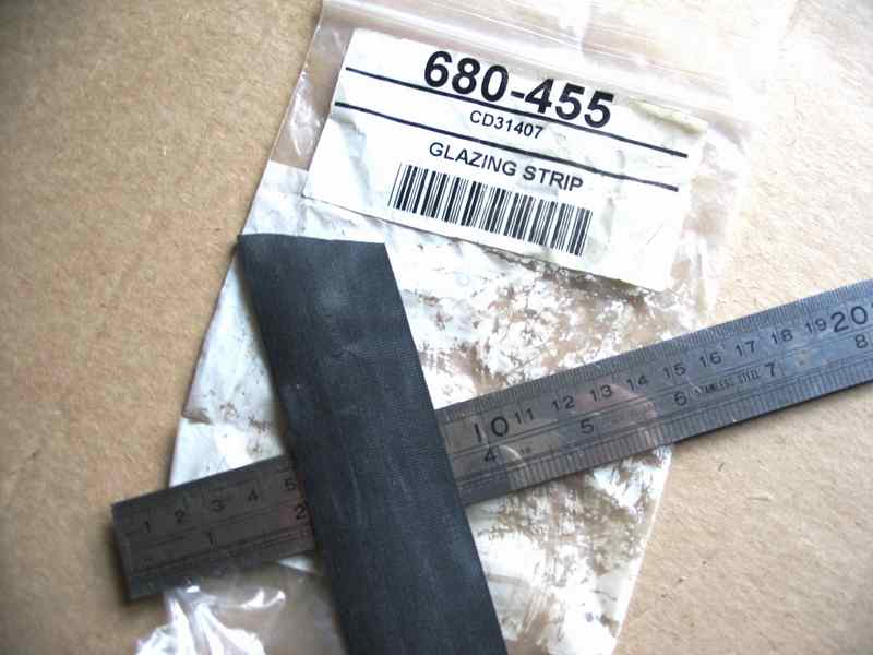

Then I found that I had a roll of the correct tape with the perfect thickness sitting on a shelf in my garage and it worked like a charm. It is from Moss and is wide enough to leave an excess all around. Then I trimmed off this excess with a sharp pointed knife.

I bought and used a TRF gasKet for the windscreen in 1990 during the restoration of my 1958 TR3A. I don't know what they are supplying now but I'll relate what I found out about the roll of gasket shey sold me in 1990.
The roll looked like the one from Moss, but it was a like a foam cell sponge. The cells in the foam were "open-cells". This means that it will absorb water into the open cells like a sponge and it leaked rain - almost as if it was not there. Also it was so stretchy that when I tried to pull it tight, it became much thinner and actually cut right through itself on the sharp lower corners of the glass. So I took it out even after sealing the edges with clear silicone bathtub sealer in a squeeze tube.
If TRF have switched to the solid rubber similar to the Moss-supplied glazing rubber, I'd say buy from them. But another time, I bought a roll of this from TRF and while it was like the Moss product, it was too thick to fit it all into the frame and the rubber was too hard (not flexible enough) to easily wrap around the glass. I tried holding this rubber glazing strip over the edge with masking tape till I could finish the assembly but I never succeeded. So at that time, I removed it and re-used the original (from 1958) textured tape remnants that I still had from the time when I dismantled the windshield in 1987.
