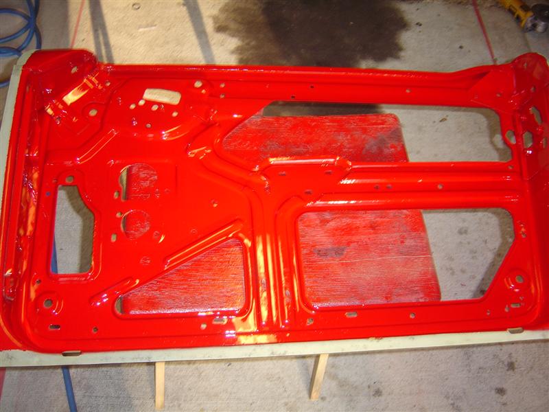

just finished painting the inside of the door skins, left bare matal around the edge for bonding adhesive as required by directions

TR6oldtimer
I know you are going to do this, but just in case, a simple reminder to be sure to apply your sound deadening material before you put the skin on.

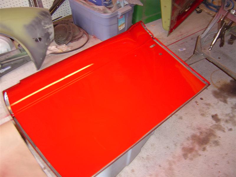

ok driver side door, the skin is on, surpriseingly it was fairly easy, the skin zipper I purchased is a POS so dont bother unless you are skinning your doors with tin foil, so a hammer and rubber sanding block worked just fine, I tack welded the top but glued the whole skin so when it sets up should be good, the only minor body filling I will have to do is where I used the skin zipper, very minor though
