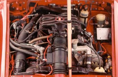

I run an oil cooler with the thermostat shown in the link from the post above. Works great. That particular thermostat is a bit of a pain to mount though, but I found that a couple of adel clamps around the hose connections, one on each side did the job quite well. Thermostat shown in lower right hand corner of photo.
