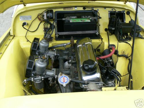

I harvested a lot of engine bay pics off of eBay while looking for parts and collecting information for my rebuild. This one is fairly clear, of a "1960 TR3."
The big holes for the solenoid and the voltage regulator take a push-in spire nut insert, and a #12 (i think) round head sheet metal screw.

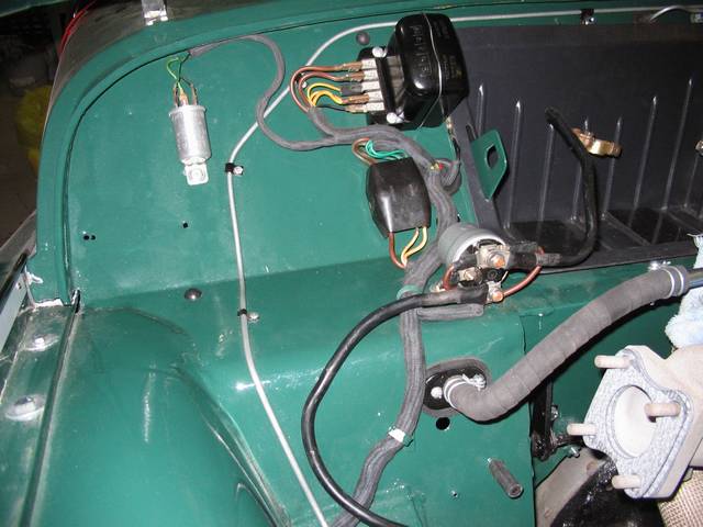

Dick - In the photo Moses attached, the Comm. No. plate is in the wrong place as well as the relay for the directional signals. It should look like the green TR3A (TS 81551 L) that we finished in 2006.
