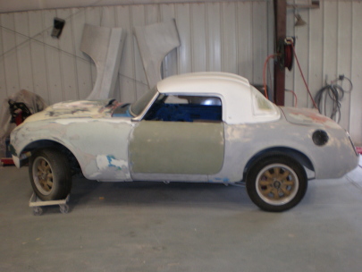

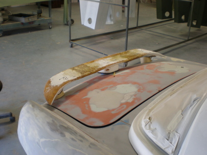

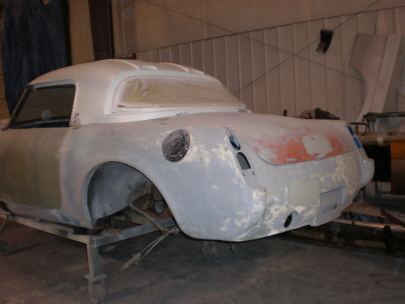

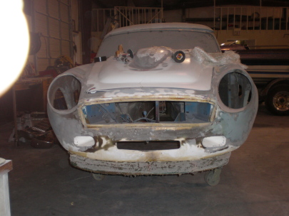

Dropped by the bodyshop today to see what has been done while I was out of town. They've started fitting the 'chin spoiler' and are beginning the reshape of the grille area.
I think these changes are going to give the finished product a wider stance while, at the same time, making the hood look not so massive.
Next week, they'll cut the 'chin spoiler' to size, start with fiberglass on the grille surround & mount the hood on its hinges/gas struts for the first time!
- The 'chin spoiler' in the photos still has to be cut to size (probably an inch off) & shaped at the edges.
- The dash surround shaping is in it's first, rudimentary stages (yep, it is going to be smaller & will be almost an oval when finished).
I'll continue adding photos as work progresses.
{Oh, everywhere you see body filler, it's just to skim coat a specific or a skim over the fiberglass....as Jack knows, my bodyman ends putting more body filler on the floor around the car than on the car itself!}

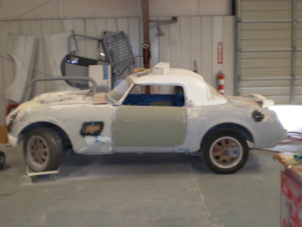

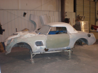

Thanks, Rik...Right now it is in the paint booth as they finish all the fiberglass work & put down the white epoxy primer....long way to go yet; however, they want to start designing the striping to match the car & hardtop.
So, I was at the bodyshop this morning...we've changed final color scheme a little (things happen as she evolves)....gonna go with Porsche Seal Gray metallic for body & for the twin stripes, gonna go with Porsche Polar Silver...& then the clear coats will also have metallic in them! In the sun, it should blind everybody who looks directly at it!
& I'm thinking about powder coating the windshield surround & the vent windows black......need everybody's input on that!
