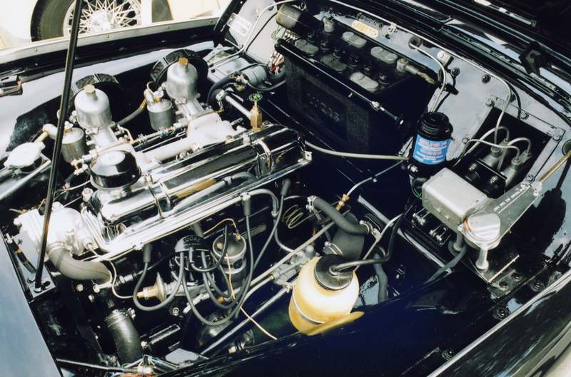

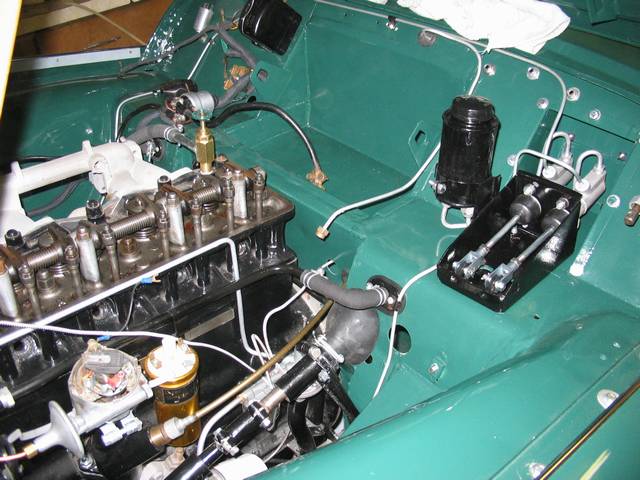

You can see the beading on the carb side of the engine bay where the curved side strip is secured to the inner vertical flat of the fender with 4 round-head screws. When I ordered my wing beading in 1988 when I was doing the restoration, I don't know if the beadings they shipped were for a TR4 with a different curve or if they were for a TR3 and they just had the wrong curve. So I had to slide out the original ones, sand off the rust, re-spray them aluminium colour and slide them onto the newly purchased ones. The one you see on the far side is the original one, now over 50 years old from new. The same on this closer side.

I don't know if things have improved in recent years, but about 10 to 15 years ago the beading for the TR3A did have the wrong curvature along the bonnet opening. The only option, if you didn't have your original one to hand, was to cut slots in the galvanised blade. Hopefully the ones available these days are a better fit.

Nick - The beading I bought about 2004 for the BRG TR3A that I restored had the correct curve for those side strips. I have seen several very nicely restored TRs where the restorer merely sniped the side strip and it looked horrible.
