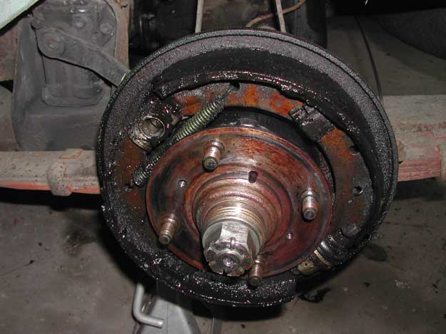

I took a drum off the TR3 and this is what I saw.
There couldn't have been much braking going on, could there?
I can't tell if it's grease or oil, actually looks and feels like a mixture, so I'll replace both seals.
Always sumpin'.

At least it kept mean ol Mr. Rust away. Looks like it will clean up real nice..........but could the bearing grease be getting in there somehow? Where could the grease come from?

If it were possible for that brake to hang up, it would have smelled great a few months ago...Castrol Smoked Roasted Chestnuts.
You could probably market them at the races.

That's gotta stink (literally.) Gotta be diff fluid. Can you smell it?
Are those 10" shoes? If you need 'em, I have an early spare set fits TR2-TR3, not 3A.

I recall the Lockheed rears on the TR2 had vertical wheel cylinders, whereas the Girling's are set at an angle of around 45 degrees, as in the pic.
Seeing the Girlings had an additional oil seal in the axle housing as well as the one in the hub, you don't often see them leak diff oil as badly as the old Lockheed type was reknowned for. Axle vibrations were thought to cause early failure of the single hub seal.
Once the heavy diff oil gets fried by the brakes, that's a typical sight that greets you, sometimes only spotted when it gets so bad that oil seeps down the backing plate and drips onto the garage floor.
New seals and a brake reline should fix it, and for even braking, it's worth getting the other side relined to match.
The wheel bearing has a grease fitting, so over-enthusiastic greasing of the bearing can push grease out into the brake area. There is a seal for the bearing, of course, but it won't hold much pressure.
More likely, the inner seal is bad (the one that keeps oil in the axle), so the oil is washing through the grease in the bearing and carrying a combination of them into the brake.
OTOH that slave cylinder looks suspiciously clean and the mess looks suspiciously like what I found after a slave had been leaking a little bit for a long time ...
Good luck breaking those hubs, Doctor, let us know how it works out for you. As I'm sure you're aware, just sticking them in a press is a Bad Idea as the force required to separate the hub is also enough to distort (and ruin) the hub if it's not solidly supported over the entire area. PM me if you'd like some articles on substitutes for the special Churchill tool.

Twosheds
It smells kinda like gear oil, but feels greasy. I suspect The Randall is correct; it's a mixture.
I apologize for the confusion about 10" vs. 9" drums. I call my widemouth a TR3 instead of a TR3A because that's what the commission plate says it is. The TR3A designation was given to the widemouth cars after the fact by enthusiasts to differentiate the widemouth cars. This is a bone of contention nowadays and I fall on the smallmouth/widemouth side of the fence. It's a carryover from aviation where the data plate info, not common names, must be used to fill out forms.
So anyhoo, they are 9" drums on TS 56882L. I have some 9" shoes over in the Lab. I'll rebuild the cylinder, too, since the oil/grease got on it.

I called the mechanic who did my TR3"A" racecar rear. He used a press to open (forgive me if I do not use the term "break") the hub. His back problems keep him from working on heavy components now, so he told me to take the hub to a machine shop to open the hub using a press. I, too, remember reading that a press can cause damage, but I also trust this mechanic.
This causes internal turmoil.
I seem to remember that someone on this forum has a hub tool that he offered to lend to any forum member in need, but I forget if it fits a TR3. Oops, there I go again. TR3A.

Could be mistaken, but I think John has the upper return spring on the wrong side of the shoes. At least I know it's supposed to go behind on the earlier brakes, and I don't recall it changing.

Didn't know about the early 9" brakes though. And I'd forgotten about the grease fitting on the bearing housing so I went out and gave mine a couple of shots.

Twosheds said:
I can't tell if it's grease or oil, actually looks and feels like a mixture,...
Grease is oil. It's mixed with a stiffener, typically a soap. You can also make a grease by mixing oil with brake dust.

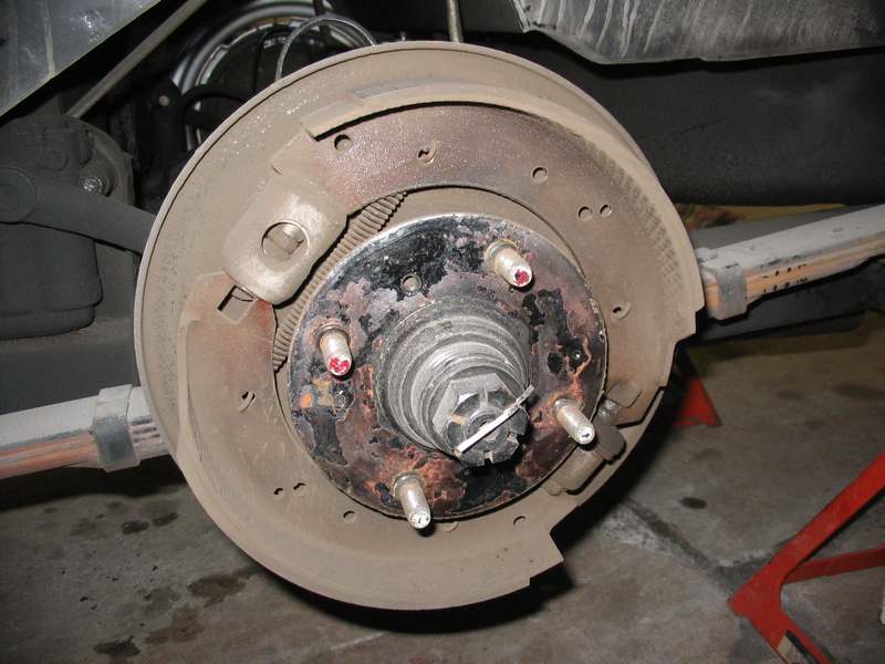

John - Here's a photo of my 10" rear brake on the driver's side. Someone above pointed out about your spring. Notice how my upper spring is attached. Compare this to yours.

I checked the TR4 shop manual (which shows the 9" Girling rear brakes). It also has both return springs behind the shoes.
Don, you're supposed to brush a little used engine oil on those leaf springs occasionally. Keeps them from rusting between the leaves

Yep, return springs always go behind the brake shoes to pull them back against the steadying posts on the backing plate.
Incidently, there are little white felt bushes on these posts, and if they are missing, this can cause the shoes to set up a rattle that is very hard to pin down.
