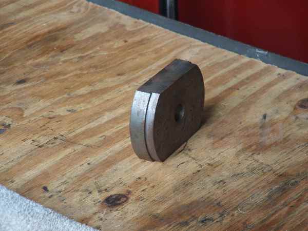

This is a "home-made" liner tool for Alfa 1750's but p'raps a similar setup could be turned out for the TR liners. It allows removal without damaging the things. A piece of all-thread and a slide hammer from the top side is the method I've used for stubborn removals.

Re: Help!! how do I get the liners out of a TR3 en
Great looking tool. One of my buddies owns a machine shop...and I have a key. Headin' over there now to make a tool.
Thanks for the idea!
