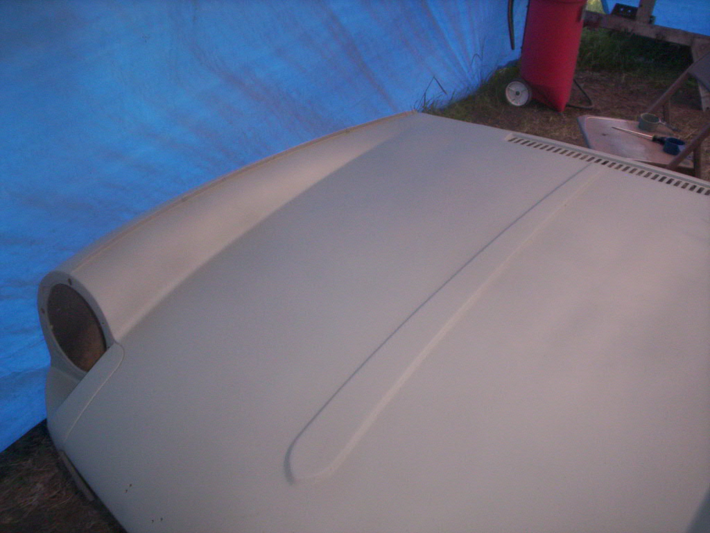

Finally got all my sandblasting done. Well, all I am going to do at the moment. Now have the exterior of the body, boot lid, and bonnet in epoxy primer.
1st time doing either job. Sandblasting is dirty messy work!!! Sand gets EVERYWHERE. Leaves a nice "tooth" for the primer to adheare to.
I have never used a paint gun in my life so I was worried about my results. So far I have managed to cover 95% of the parts I am working on with a good coat of epoxy primer and only have a very few runs to show my inexperience.
Now that the rust work has been put on temporary hold I can begin to learn to beat out dents. Here again I have no experience. I don't even know if you pound on the high side of the dent and have the dolly on the low side or visa versa. I guess I'll be learning real quick.
Included an attachment of the bonnet.

Hey, Darwin - Been following your progress, and the latest pic looks great! Glad things are moving along for you.

looks good for someone with no experience.
you may want to consult a pro prior to ("pounding anything!")
