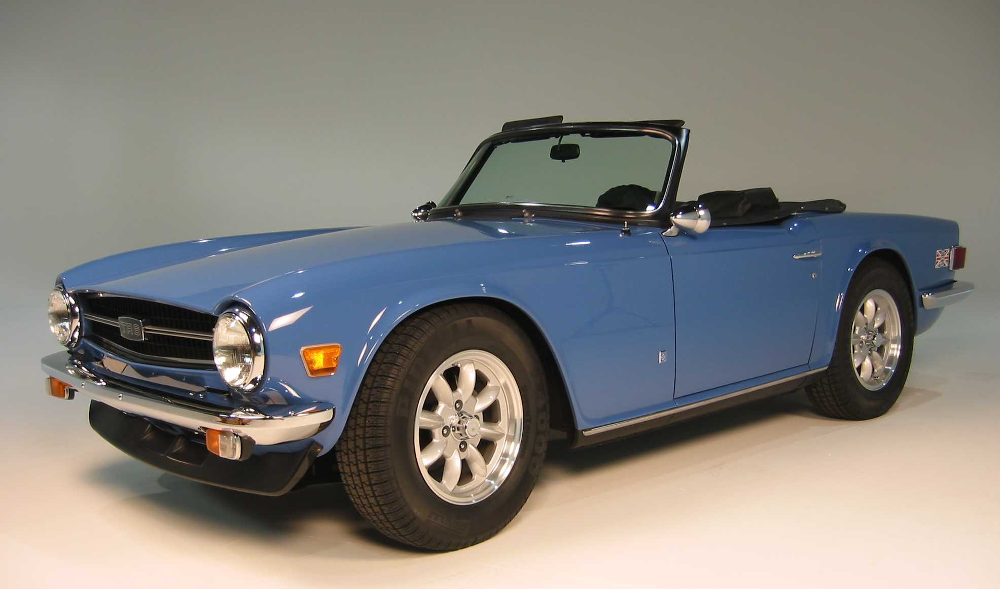

Last night I compared a set of Pana's to my Superlights.
Maybe the Panas polished area is a small bit brighter.
Otherwise, I am very happy with my Superlights on my TR6.
Wtihout the name showing on either wheel you would not really know which one is better looking. I think the Panas weigh less, but not by much. If you want lots of pictures of my Superlights, send me a e-mail.

I have Superlights on my TR6 and they look great. They may be slightly heavyer than the Panasports but its not that much and they are a heck of alot lighter that the Stock Steel wheels. I am glad I went with the Superlights.
