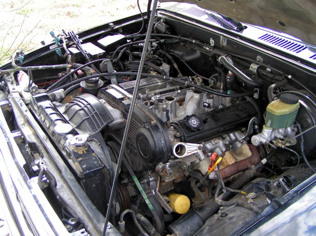

Anyway's here's where I stand so far... Lots farther to go
I'll have to go buy more wrenches tomorrow.

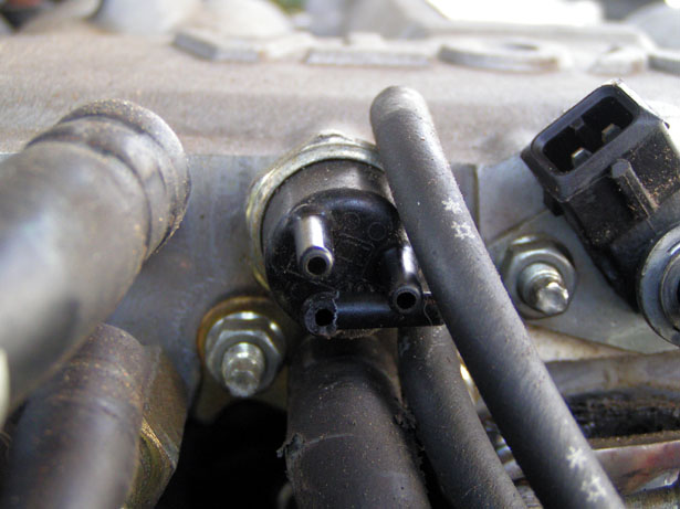

And already I broke some *&#% plastic vacuum sensor - *&%# it! And lost one of the washers to the banjo fitting on the cold start injector... frickafrack

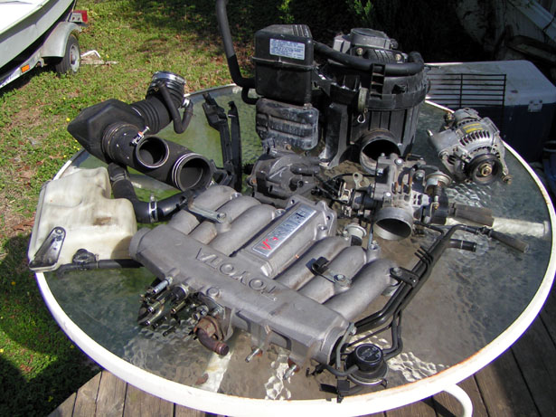

Well, I looked all over and found my crescent wrench /ubbthreads/images/graemlins/thumbsup.gif, so now it looks like the truck puked on my porch table...

Platinum
Glad I'm not involved... all the parts on yer table there look positively PREDATORY.
I'm gonna have baaad dreams.

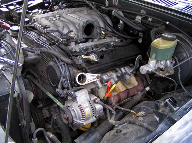

I've been at it since around 11:30 thismorning, and it looks like I just started... Here's what it looks like now:
Now, it's down to looking like a real engine /ubbthreads/images/graemlins/smirk.gif
Now all I have to do is remove the radiator, the front of the engine, the rest of the intake manifold, the exhaust manifolds, the cam covers, the cams, then I can get the heads off /ubbthreads/images/graemlins/rolleyes.gif

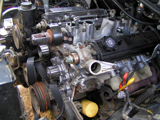

Aha! I got one on ya... You DON'T have to remove the A/C compressor to get the belt tensioner off (maybe one bolt). I replaced the timing belt and water pump a few months ago. Just take it off with the aluminum front bit that the fan mounts to... Then you can recompress the tensioner in a vice, put a pin in it before you reinstall... then pull the pin and turn the motor over to let the belt tighten up... No problems. /ubbthreads/images/graemlins/grin.gif The power steering pump will have to me moved though.

kennypinkerton
Ok, I can now sortof see the heads... Still alot to do though...

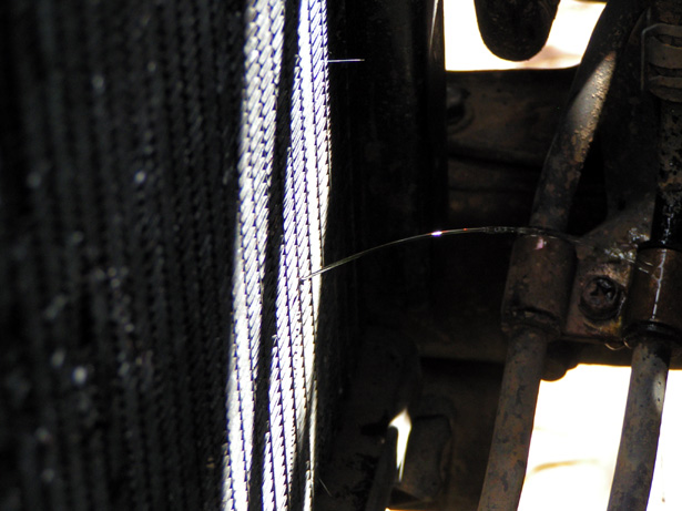

And so far in one hour today, I've only sliced my finger (real close to needing stitches - but the bandaid is holding it together real good), and put a pinhole in the radiator /ubbthreads/images/graemlins/rolleyes.gif
Honest I was only gonna fix the broken engine! Not restore the danged thing.
