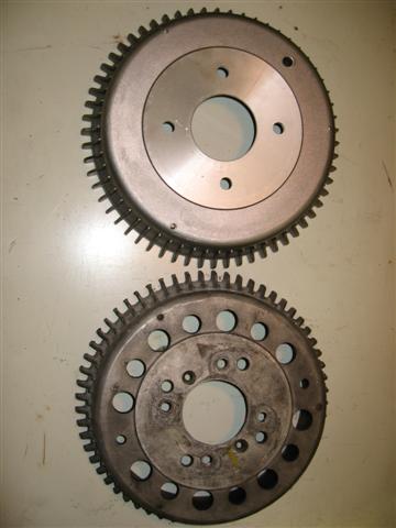

Though the backing plates have been drilled/vented, the drums have been replaced with Datsun Alfin's and the shoes have metallic pads the brake shoe frames and the cylinders are as far as I know original. The brakes are 9" x 1.5".

I don't think I directly answered your question--No, I am not going back to the stock drums. The Alfins are the same size--just different material--as the original steel drums. The frames should theoretically be the same as stock.

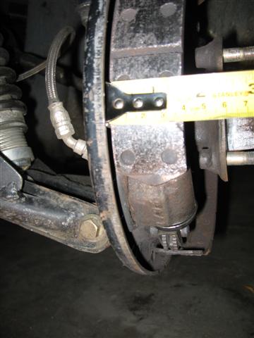

The brakes are 9" x 1.5"....I'm now learning from some other VSCCA Courier drivers that the brakes were also used on Triumph Heralds and perhaps I need to go over to the Triumph forum to see if I can develop a source.
[/ QUOTE ]In this case, the Triumph forum has come here. /ubbthreads/images/graemlins/wink.gif
Herald front drums are 8 x 1.25" Girling 2 leading shoe, so they won't work. (Rears are 7 x 1.25" Girling leading/trailing shoe.) Maybe they're TR brakes; offhand I don't know how wide TR drums are, but they might be 1.5". Note that some TR front drums are 10".

Thanks for the info but in the meantime I got a call from Pete at Worldwide Auto Parts who ID'd the brakes as being from a TR2/TR10 and is sending me a used set of shoes that he had in stock.

...I got a call from Pete at Worldwide Auto Parts who ID'd the brakes as being from a TR2/TR10 and is sending me a used set of shoes that he had in stock....
[/ QUOTE ]Well, I'm not surprised either that Pete a: was able to ID these and b: come through with parts. TR2 makes sense. (Note that the "TR10" is incorrect; they would've used much smaller 7" brakes.) After my post, I did come across one Girling catalogue reference that gave a part number and a cross-reference to "Triumph"; unfortunately it did NOT give a model.

[/ QUOTE ]I couldn't agree more about Pete. Again, though (see above), the Triumph/Standard 10s used smaller Girling brakes.
The early TR2 (Lockheed) rear shoe reference is correct at 9" x 1.75"; later ones had bigger shoes...and then, ultimately, Girling brakes all around with the changeover to front disc brakes.
It could be that Pete was thinking of the Standard Vanguard range, which I believe used Lockheed brakes throughout; some Vanguards did indeed use a 9" x 1.75" shoe.
I have a pretty thorough Lockheed brake catalogue covering 1948-62 and might be able to help further. Let me know!

Well, the brake shoes arrived today from WW and--despite promises that they would fit--as Andrew warned they are 1.75" wide. So it's back to the internet...
Nevertheless the pattern of the holes, adjuster notches and radius appears identical with the ones on the Elva and if that is the case I am going to take them to a machine shop and hopefully have 1/8" removed on both sides of the shoe.
My latest good information source identifies the brakes as being identical to those that were used on a Morris 1000. Does anyone have any suggestions as to where I might obtain shoes for that vehicle? Thanks in advance for any leads.
