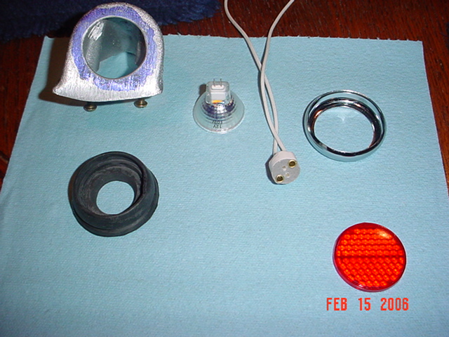

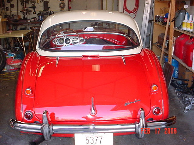

    Update: Converting BN2 reflector pods to working lights.
    As I said earlier, the BN2 has separately mounted "pods" for rear reflectors. I was able to convert them to working lights.
    I purchased Moss # 544-700 reflector assemblies. The solid BN2 pods were cut out with a 1 3/8" hole saw. the rubber backing was cut out & shaped to hold MR11 10 watt type bulbs. The rubber fits the cut outs, holds the bulbs securely, & the chrome rings hold the lenses on tightly. Looks exactly like the original BN2 reflectors.
    The new lights are wired for stop & turn functions. The one amp extra current draw of the MR11's had no noticeable affect on the flasher rate. A pic of the new components is attached.
    D

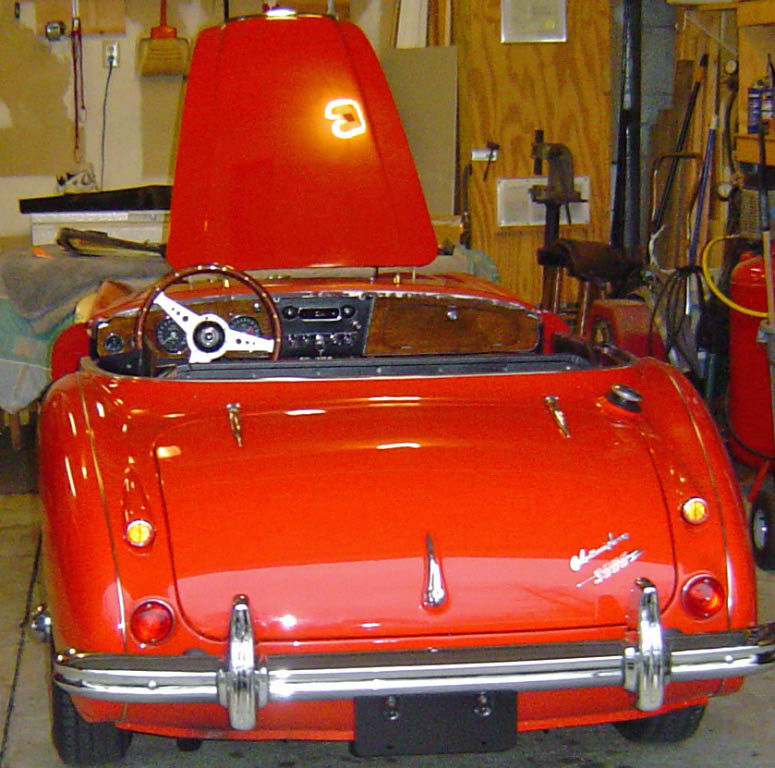

    [ QUOTE ]
    Looks good. How did you run the wires ?
    [/ QUOTE ]
    Got an extra pod from Moss to experiment on first. The thing was sand cast with the rough side out. Would take hours of grinding & polishing to make it usable. I grounded one wire on one of the pod mounting bolts. Drilled a small hole, with grommet, ran single wire through it. Having three holes instead of the two original is no big deal to me. The rear pod face is pretty thick but the rubber fits nice & tight in a 1 3/8" hole. Took some work with a rotary file to remove some of the inside casting lumps. Thanks for the help on parts selection.
    I also have a center high mounted stop lamp, so things are well lit now. See pic.
