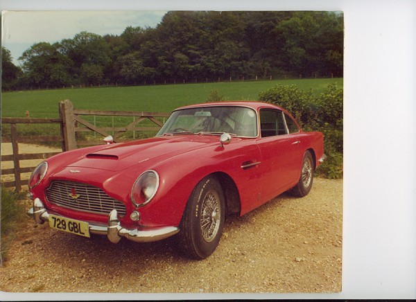

Voilà Bruce! A picture of my DB5 /ubbthreads/images/graemlins/grin.gif
Curtis

Werry nice, Curtis. Beauty.
Somehow I seem to be of the opinion all "new" styling seems generic (and boringly similar) but the cars of the era of ours are somehow much more distinctive and ~remain~ alluringly contemporary in appearance.
Pro'lly just showing my age an' prejudice tho... I'll go an' take th' med's now: /ubbthreads/images/graemlins/thirsty.gif

What a great car. I don't know what it is but they are just super looking cars.
Bruce

Hello Curtis,
DB5\1379\R, (I noted the AMOC badge) and strictly speaking the 'Bond car' was a DB4 that became the DB5 prototype.
I had DB5\2066|R and did a lot of work on it, quite practical for the home mechanic to work on. I also enjoyed a few visit to the 'works', what a place. I don't have the same affection for the modern Aston's anymore, the spirit is just not there.
Alec
curtis
piman. You say that "strictly speaking the Bond car was a DB4 that became the DB5 prototype". Yes,that's right a DB4 series V vantage.In the book the Aston was a DB MK111 which Bond chose from the car pool in preference to a Jaguar as the Aston was an inconspicuous colour--battleship grey!!
Curtis
