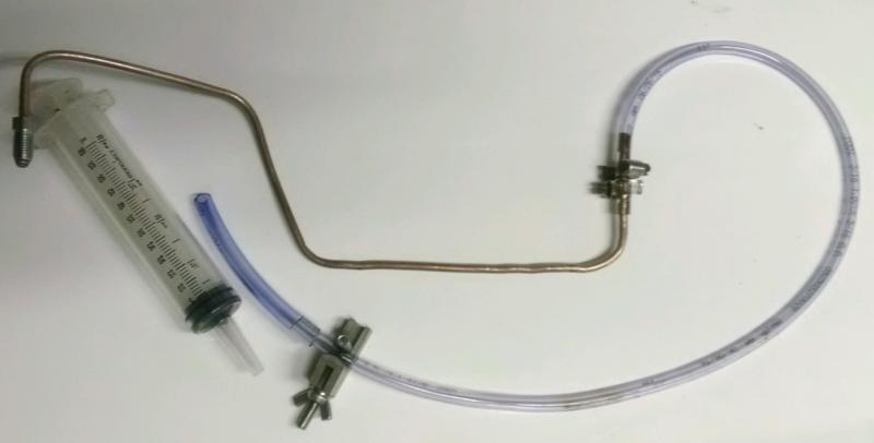

I made this recirculating bleeder in order to 'bench' bleed a new MC installed dry in the car. Pipe attaches to MC output with clear tube into reservoir. Pump the pedal slowly to force the air out of the MC into the reservoir. Also shown is the syringe used for general bleeding.
