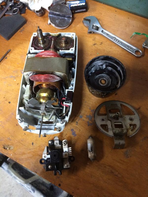

Not a major appliance but required repair nevertheless. We got this Mixmaster 48 years ago. SWMBO was unhappy when it started making a racket a couple of days ago. Took it apart and found the gearbox dry. Re-greased it, cleaned up the commutator, oiled the bearings and Bobโ€™s your uncle.
It required service after 48 years... donโ€™t makeโ€™em like they use to :jester:
Platinum
Nicely done, Elliot! "Keep 'em flying!" :wink:
