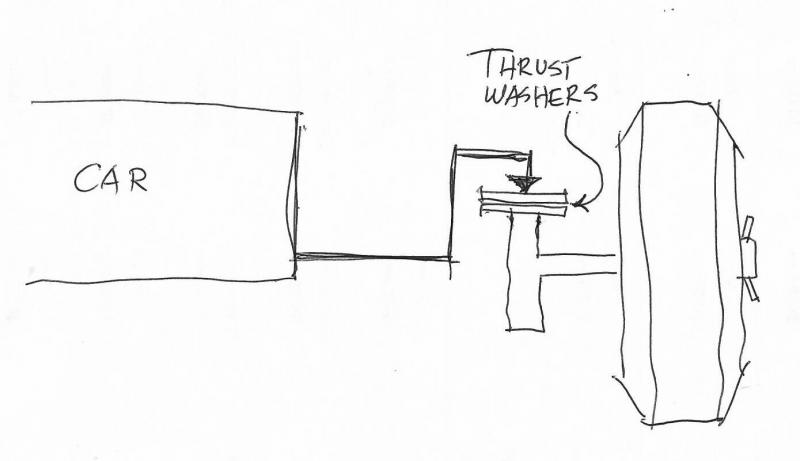

steveg
Agree with Bob. Schematic of car weight on thrust washers:
Possibilities:
If steering won't auto-return to center, back off on adjuster screw slightly.
Lube upper trunnion/thrust washers.
Replace thrust washers with needle bearing set, available from all the suppliers.
For 2" play: check fore and aft movement of worm in box. May need to reduce shims on front to bring to zero play. Read previous posts about accidentally unseating upper steering box ball bearing with catastrophic results.
