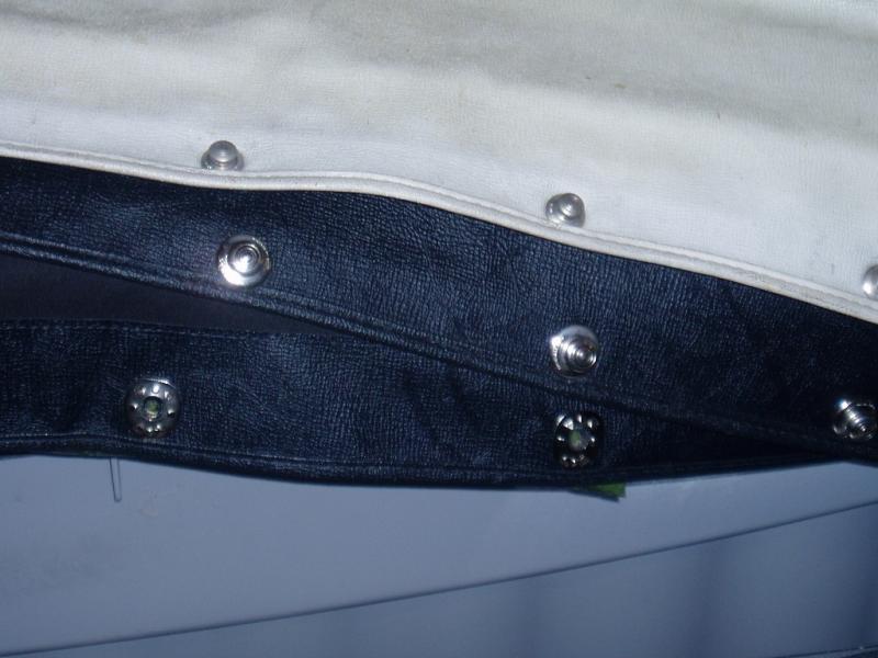

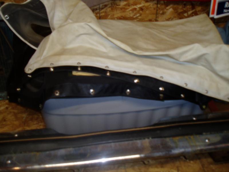

Here is the pic. Black top for comparison. Will PM with details.
Tom
TomMull
Apparently there were 3 Types used on TR2/3. All I can tell you fore sure is that the ones in the picture are too small for my pegs.
