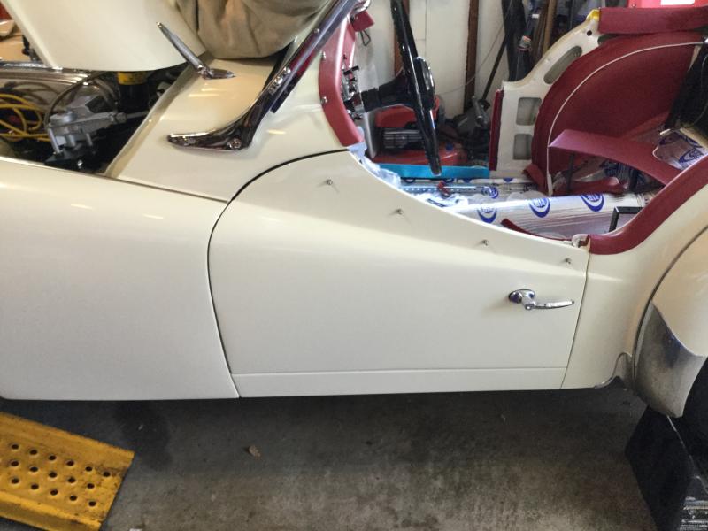

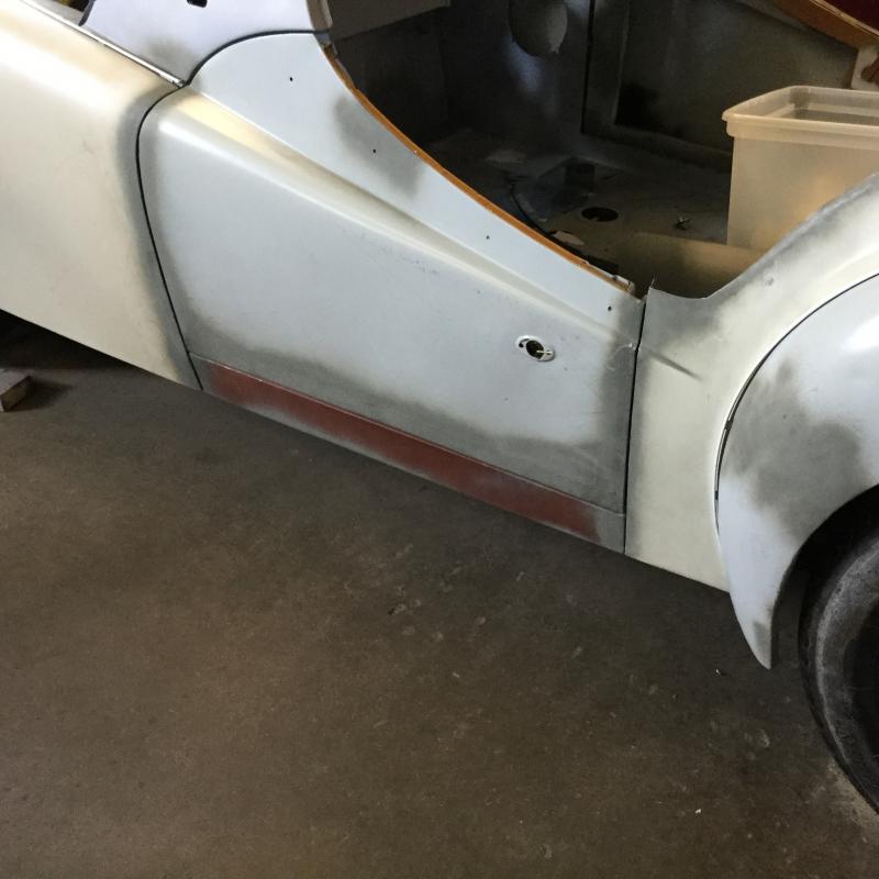

Ok, the doors fit fine pre-painting, all hinged up:
They also fit fine now after painting, just like shown above, BUT only when held in place, door latched, with the hinges laying flat and NOT screwed into the A-post.
When the hinges ARE screwed in, the aft edge of the outer wing interferes with the door such that it can’t be closed and paint touches paint at the front door upper edge. The outer wing is firmly bolted into the A-post with a no-gap fit.
I don’t see how shimming the body would help, since I have nice even gaps all around the door. Might this be a time to shim the hinges? I did just check- the repro hinges are the same thickness as the originals. The body was removed from the chassis for painting, and one could reasonably assume the same shims were used post-painting, but the body shop did that and they are out on CV19 lockdown.
What say ye? Shim the hinges? Jim

I made all those adjustments before painting mainly by bending the hinge mountings in the doors by dollying them forward trial fit umpteen times until happy with end result, but after painting you could look at shims.
Graham

A pic of the bolted door would help. I think you are saying that the when you tighten the hinge the door moves forward? Or, are you saying it moves forward as the door pivots open?
charleyf
Jim,
One other option is to try readjusting the front fender. You only need a very small movement of the fender to allow the door to clear. The movement would likely be to try to pull the fender out.

I’ll try pull the fender out...
what is happening is that you need to have the door open to screw in the hinges, right? And when I do, the top part of the door sits in too far to clear the valence without making contact. I’ll take a picture on my next try! As always, thanks!

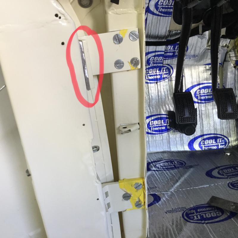

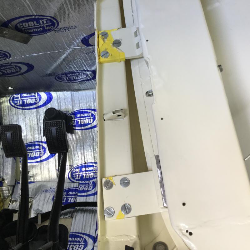

Update: Holding the door in place, I can see quite a gap between the hinge and the A post. I have some 2” flat bar stock that may be the right thickness that I can drill out to make a shim... I can do that during a coffee break while I’m here stuck at home working.
10-hours per door indeed! Jim

Jim, your photo shows the door not yet final painted so you could try to bend the frame hinge mounts to take up the gap.You may find the area where the hinges mounted to the door is bent in so if you use a suitable drift inside the door and give it a wack both top and bottom and refit it won't take much , if you go too far just tap it back a bit and try again
Graham
CJD
Like Graham says, the hinges can be spread at your stage in the build. The brass hinges are a bit easier than the steel, but both are bendable.
