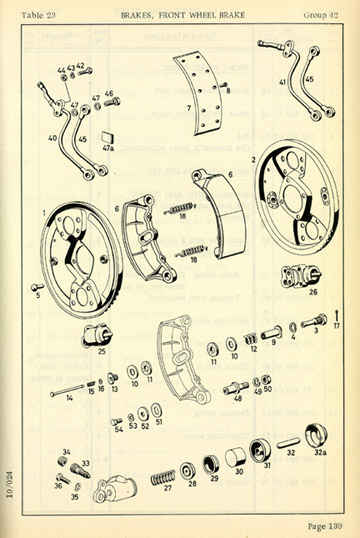

Learned a couple months ago the "self-adjusting" brakes on a Topolino are dependent on the frictional resistance of a couple washers holding the shoes to the backing plates, and the ~proper~ return-spring tension... the new springs supplied in most "kits" for the car have too much tension and pull the shoes back to a "zero" position, making it impossible to get a good pedal. We must have run half a gallon of brake fluid thru the system thinking it a hydraulic issue, before realizing it was a mechanical one. Started hunting the 'net, found many others having the same problem. Solution was to S T R E T C H the springs! Found that answer from a chap in England, on a Fiat 500 forum. Strange, frustrating little cars!
NutmegCT
" ... the "self-adjusting" brakes on a Topolino are dependent on the frictional resistance of a couple washers holding the shoes to the backing plates, ..."
Doc - you're describing the self adjusting system on the Mercedes-Benz of the 1950s and 1960s. The "friction washers" are supposed to make up for shoe wear. Emphasis on *are supposed to*.
Part #11 on the diagram.
Platinum
Same principle. Whoever is making the replacement kits now likely has no idea what they're making. I used the old springs in the end, gave them a bit of a stretch too though. Resulted in a good pedal on the second stroke. Car now works fine.
