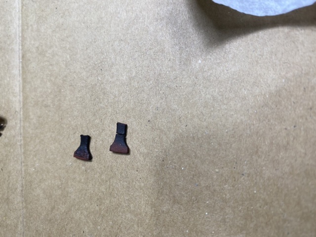

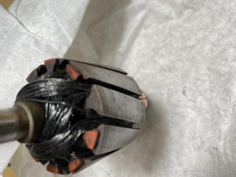

AE322397-109A-4F9D-B1D7-FBEAA63EBA56.jpg39DB463F-DEEF-4D4C-8689-BA0D26435680.jpegI disassembled my wiper motor to clean and refurbish. As I was cleaning the armature I noticed these little bits of fiberboard were falling out from under the windings. Most of them are still tightly embedded under the windings but I don’t want them to come out after I reassemble the motor. Any advice on how to get them to stay in place?

The classic material was varnish, but I'd probably use JB Weld or similar.
From the looks of it, that armature has been overheated pretty badly, which is why the fiberboard pieces are breaking.
N
NatS
would i epoxy the pieces back under the windings? i can add a dab to each piece.
I could also cut a new piece if necessary from some fibreboard or gasket material

Looks like it is well done if not a little over done.
The insulation on the windings may be compromised.

Right. If you have the option, it might be better to look for one in better condition. If not, at least double-check that there is no continuity between the commutator and the shaft (which would indicate a shorted winding). Ideally, the armature would be checked on a "growler", but I have no idea where you would find one today. (I bought an old one on eBay, but it will need to be refurbished before I can use it, and I'm quarantined 2000 miles away. )
And the less you can disturb those windings, the better. So I would probably try to glue the old pieces back, as many as you can find. They are just cushions really, to help keep the edge of the lamination from cutting through the enamel on the wires; not otherwise important to operation.
Try to work a little epoxy under the ones that aren't broken, too. Might help keep them from breaking in the future.

If you were closer, I'd lone you my 100 year old growler to test the armature before putting any effort into it. I would not worry about the cardboard. If they are loose, pull them out, otherwise leave them alone. They were there to keep the coils off the metal while it was being wrapped. Now the wires have taken a set, so they don't need the cardboard.

Now you are getting into my field. 30 years with TVA rebuilding generators. You can dip the armature into varnish up to the bottom of commutator, let it drip and then bake it out in an oven at 250 for four/five hours. Or you can buy a can of glytal insulating paint. Spray the winding, soak them with the paint and it dry. That should lock everything in and reinsulate the windings.
