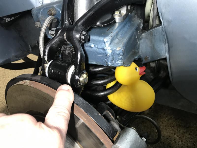

Ah, that's where that squeaky toy disappeared to. Now that I've removed it from between the coil springs, all is quite again.

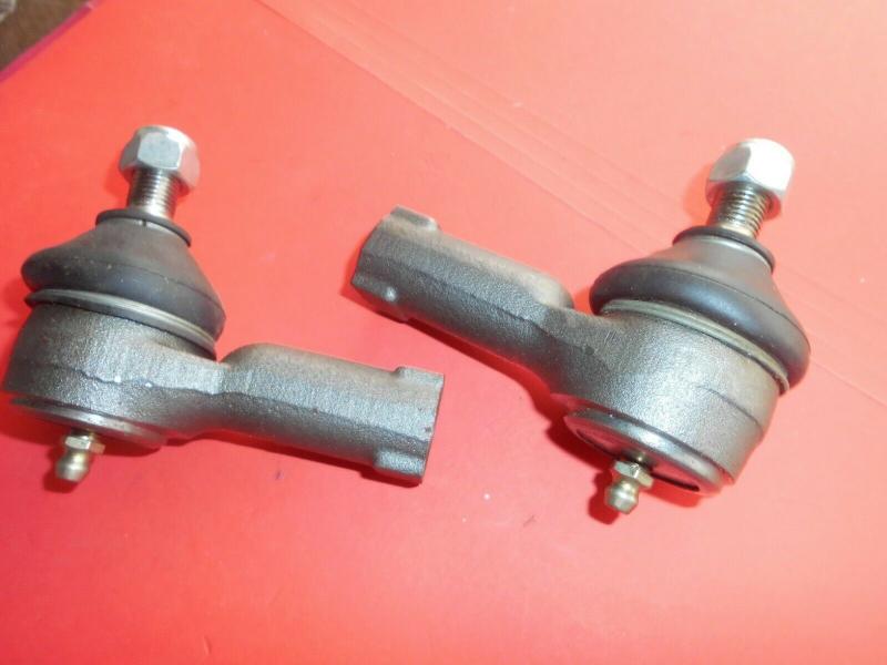

The ball end on the cross rod assembly has a worn out rubber dust cover. I'm able to push it up to see some grease.
The ones Moss sells don't have a grease fitting, so I assumed they were a sealed unit. Not so it seems. The dust cover is replaceable. If that's so, then it's like mine where you can see the ball and the grease can dissipate. I found on Ebay (photo with orange background) what appears to be an older Moss unit, (same moss part number 021-182) ball end with a grease fitting, and the dust cover is replaceable. Which would be a better unit? With or without grease fitting.

Squeak, located, the spring coils. Now it makes sense. Every time the spring would condense, it would squeak. I took a photo of it, in case others over look this culprit hiding in plain site....
