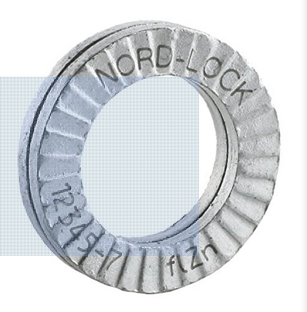

I'm using NordLock washers under my front shocks for the last couple of years. No loosening.

Steve, Have you noticed if the Nordlocks--that's the washer I was trying to recall the name of--left any impressions in the whatever soft metal the shock bodies are made of?
Bob - haven't had them undone for a long time and was not concerned at the time with wear-and-tear from the lockwashers. I believe the shocks are aluminum.
Any impression can't be any worse than the original split-ring lockwashers with their barbed ends. Those gouge out a little every time you undo them.

Good video on the anti-loosening properties of different washers:
I'm glad I watched this video; I had no idea Nord-Locks need to be stacked (looks like the pack of 10 I had to buy to get 8--I'll probably lose at least one--will be worth it).

I had tried all sorts of "solutions" before someone on the forum suggested the Nord-locks. I would get a clunk in the rear after a couple of months. Part of the problem was getting a tool into the thigh space. available. The Nord-locks have been on for 4 years and have not loosened and caused the once familiar "clunk". I intend to use them on the exhaust system the winter.

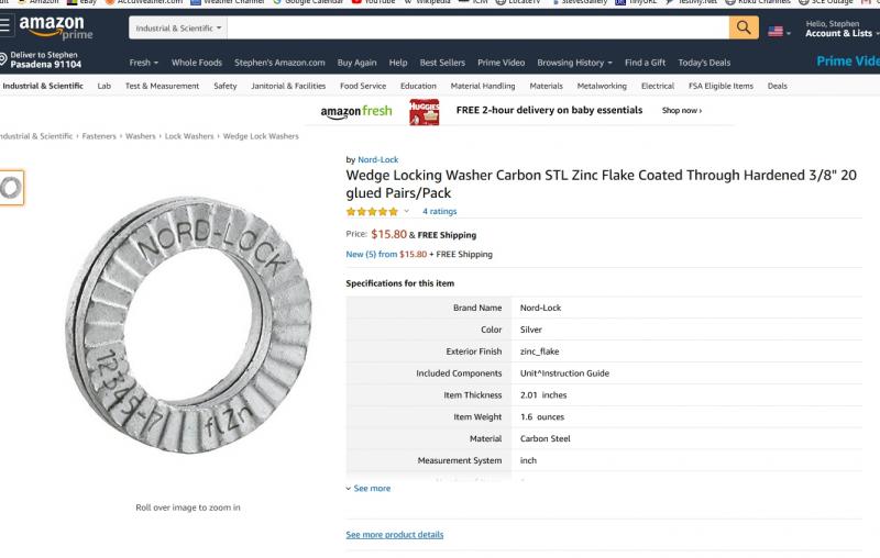

I'd like to think I'm smart enough to know by looking at them but, you know ...
do you have a part number you used when ordering them?
thanks
