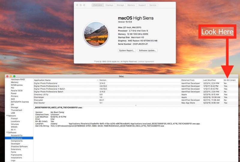

I have a mid-2011 iMac and simply can't upgrade past High Sierra. However I have been thinking of upgrading to a newer box eventually, in which case I will care about what apps will or won't run.
To determine which apps "should" run on Catalina and which definitely won't, click on the Apple at upper-left, then "About This Mac". Then click the "System Report" button.
On the System report page, select "Applications" on the left side (under the "Software" section". Once the applications on your system all load up, look to the far right, under the column "64-bit (Intel)". Any Apps that say "Yes" should run. Any that Say "No" won't.
