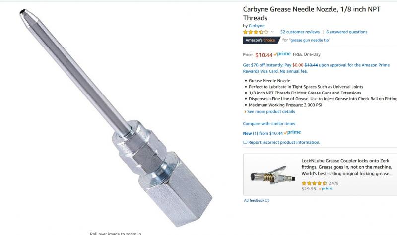

You can get a syringe or suction gun (Amazon) with a hose which will reach the bottom of the box.
Turn the steering wheel to left lock; this will allow your tube to reach the bottom of the box. Fill from bottom up until it overflows. Withdrawing tube, operate the steering side to side a couple of times to remove any air pockets.

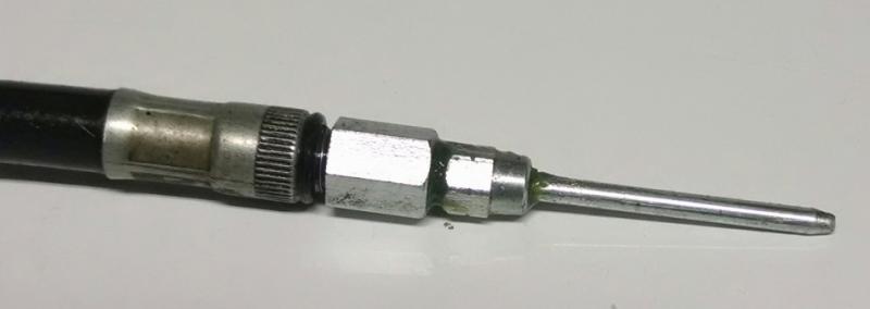

steveg
I like this for injecting Corn Head Grease from the bottom up inside the box:

Steve, thank you. I have a similar terminal at the end of one of my grease guns that I had planned to use.
