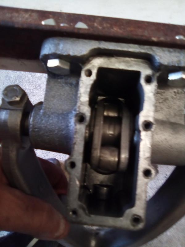

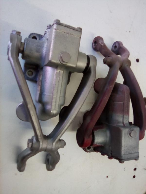

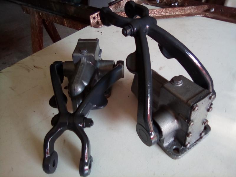

    I recently had my two front shocks rebuilt. They came back good as new, see pics. Unfortunately after a couple of weeks or so it went back to bouncing along the road ! Upon closer inspection it seems like a washer or a seal has come out of both shocks, see middle picture. Also the oil has come out , I assume. My question is

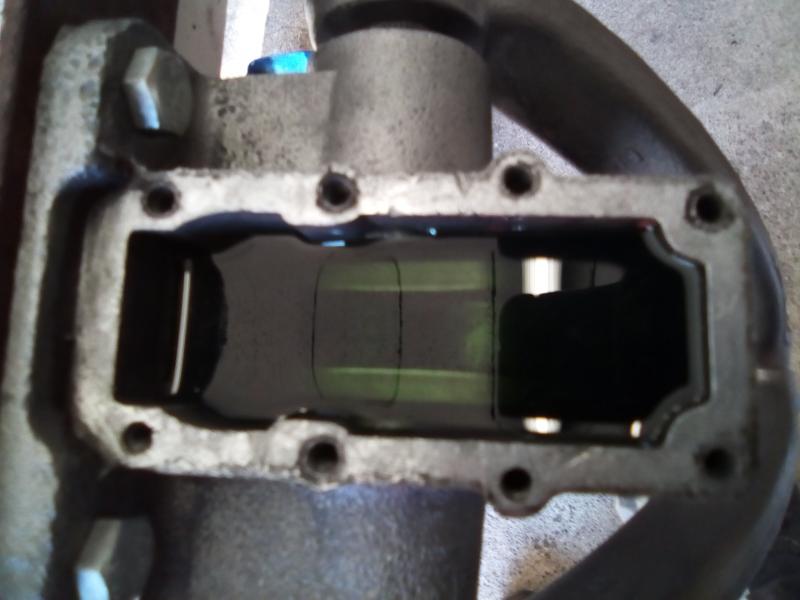

    Hi. Thanks for your replies. The guy who did the shocks did it as a favour, so I can't send it back. The question is could I repair it easily myself or is it a specialist job. See pics of the inside as sent to me at the time of the rebuild
