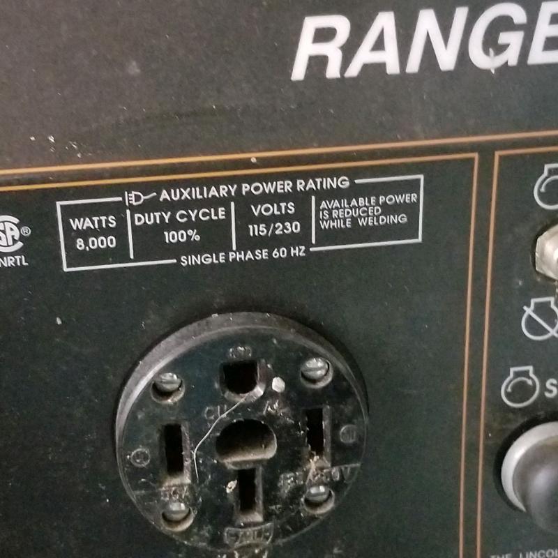

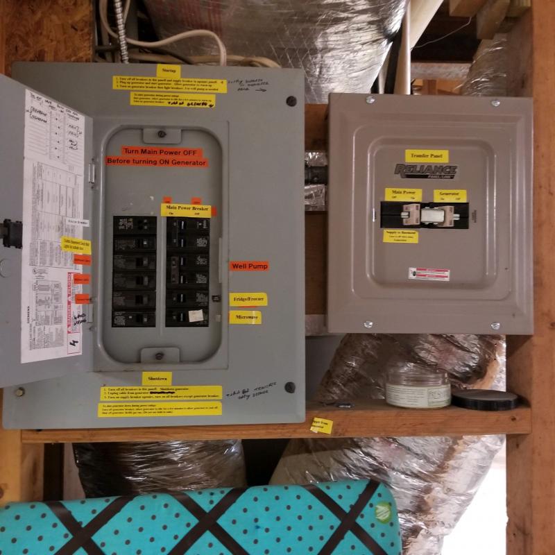

I have a Lincoln Ranger 8 as a back up generator which I got about 20 years ago. I have had to rely on it about 4 times in the 20 years. For a 6 days after one hurricane. It will run the fridge and freezer, well pump, microwave, lights and outlets to charge batteries and the gas tankless water heater. At that it is never under full load.
It cost less than $2000.00 and is also a welder.
Wired through a manual interlocked transfer switch to the sub panel.

Thanks gentlemen. David - what is the max wattage rating, and the continuous wattage rating, of your Lincoln 8?
Thanks.
Tom M.
PS - just checked my refrigerator using a watt meter: 160 watts when running.
DavidApp
8000 watts continuous.
I got the transfer switch from Northern tool.
David

DavidApp
The notes on the fuse box were there just in case I was out of town and someone unfamiliar with the setup needed to run the system.
David
