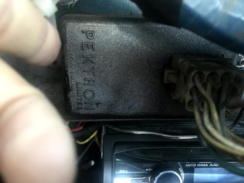

    Can you post a picture of the block you are asking about?
    I assume you have wiring diagrams to work from. However, if you don't... take a look at the link below. It includes North American and other regional diagrams.

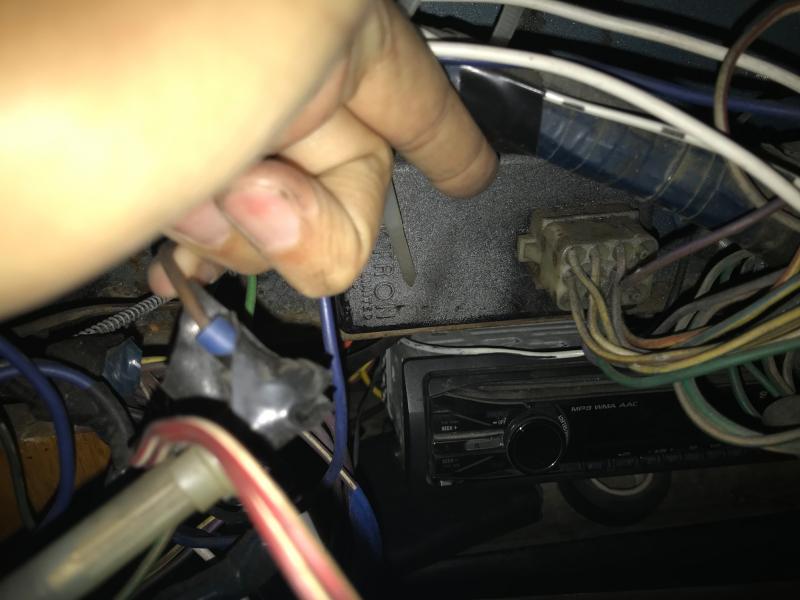

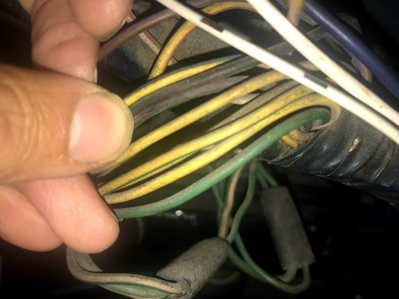

    In the picture some text can be seen behind your fingers. What does that say?
    I also see a bunch of (as many as 9?) colored wires going into the plug on the box. Can you list the colors? You may need to clean them a bit to confirm there are no secondary colored stripes on the wires.

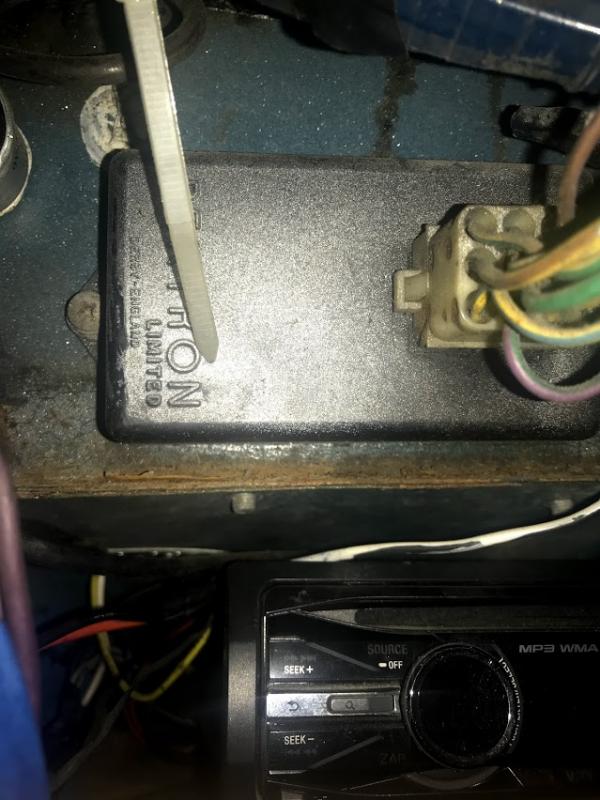

    When you get a chance, do try for a picture where the text on the box is not obscured and one that shows each of the wire colors going into the plug.
    Your signature says that this car is a '70 Spridget. I have looked at the diagrams in the PDF I linked earlier. I did not see anything like what is shown in your picture. I was also surprised by all the yellow wires in your picture. Yellow wires are not common. I have usually seen them on schematics where the car has an overdrive which would not be the case with a Spridget. The box's plug also appears to have a purple/black wire. Purple/black is for the horn circuit. That further confuses me.

    ...the box says "Pektron"
    Perfect! I was able to Google Pektron and MG and found the thread linked below. In the link, read post #4 by Norm Kerr
    https://www.mgexp.com/forum/mg-midge...ktron.2059173/
    Succinctly, it sounds like you need to change Shaggy's real birthday to 1974 or at least add '74 to his mixed pedigree for the body/wiring.
    It appears the Pektron box was also used on the '74 MGB (probably others as well).
    I like your idea to use the European harness and splice it into your existing harness as necessary. It doesn't sound like the Pektron unit is something I would want to get operational but that's just me.
    EDIT: I also found a BL tech bulletin about the box. If you are really into originality (Shaggy doesn't sound like it! ) you might be able to get the Pektron box working again using the info in the PDF linked below.
    https://www.triumphexp.com/article/m...0Interlock.pdf
