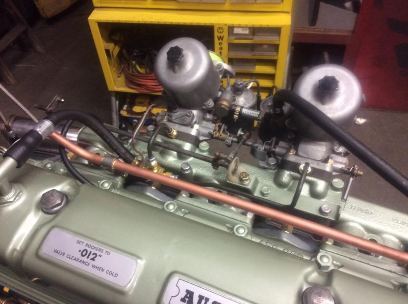

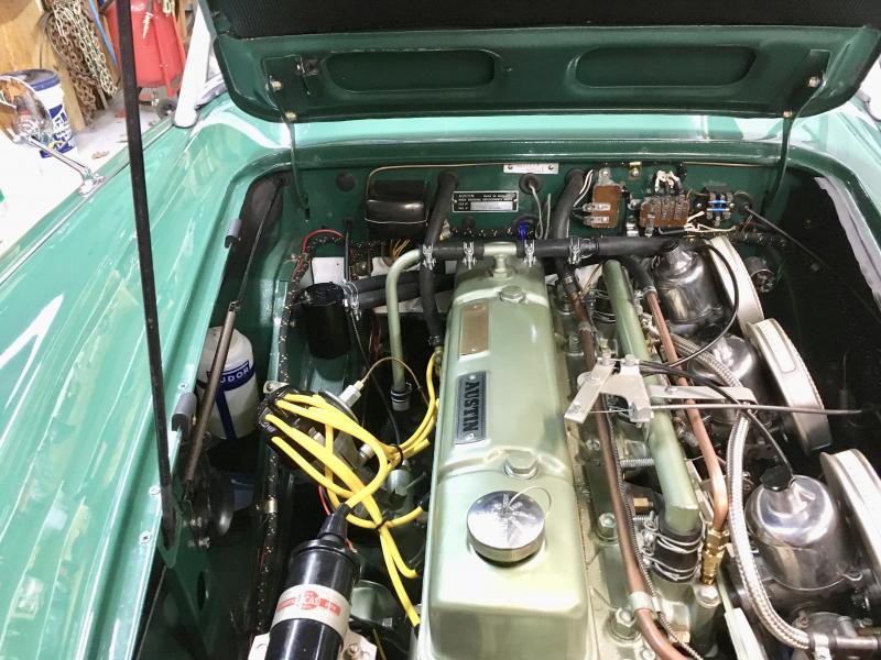

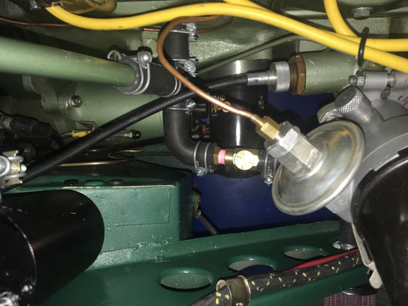

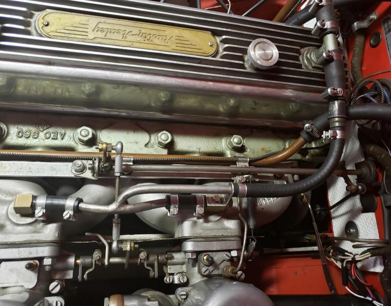

    here is a pic of the vented side and the valve. if you look close in the bottom right of the picture, you can see my filter. it is tucked away behind the brace.
    here is a pic from up top. i have a tri-carb so the vac line comes in to the front intake. the PCV valve is behind the valve cover. the hose going to the back carb has a "T" in it. the side to the carb is plugged and the back of the T goes to the oil catch can on the left.

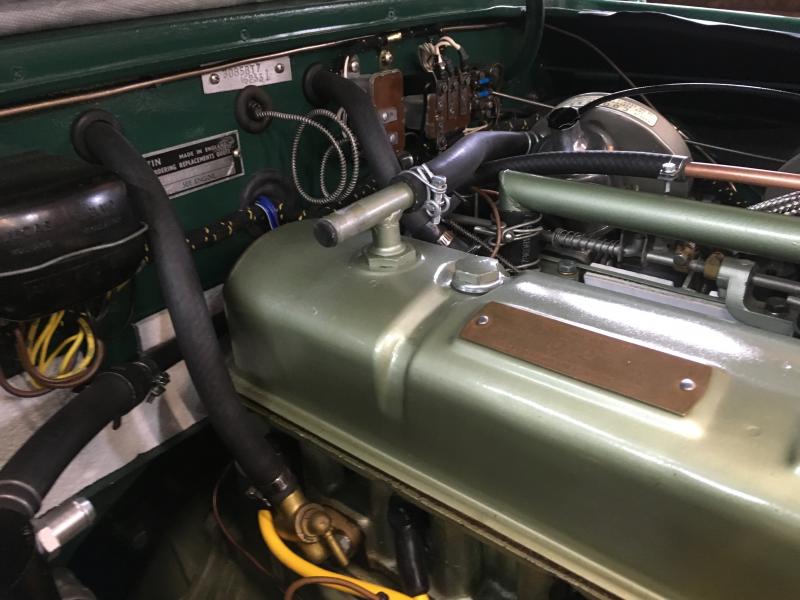

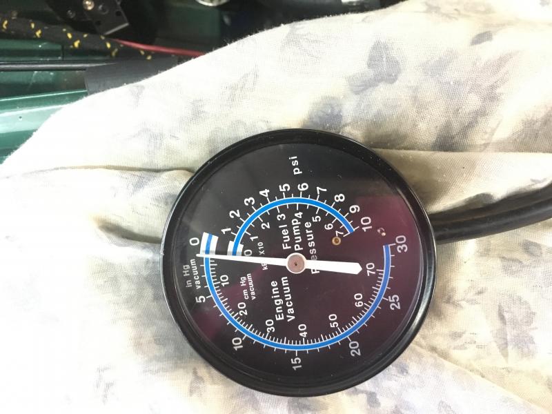

    i put a vacuum gauge on the verticle pipe from the side cover. i pull the pipe out of the rubber hose and attach the gauge at the top. You can see my rubber "T" at the bottom in the previous post.
    at first i put it over the dipstick tube and measured from there. i got the same reading but i wondered if my dipstick tube might also leak a little. so i decided to put the dipstick in and measure from the pipe. keep in mind my metal "T" at the top of the valve cover is plugged on the pipe side so all the vacuum is pulled from the valve cover.
    if the negative pressure had an effect on the oil pump, would you not see a drop in oil pressure?
    i believe the early closed systems used to leave the dipstick unsealed and the oil fill cap was vented. if you did not do this, you pulled all the air in by the seals.
    Again i do not know that the 6" of H2O is the gospel. it is just the only number i ever found. i do not have enough experience as a mechanic, especially with AH engines, to have a feel for these things.
    The one thing about the valve i used vs the fitting i had in the line at the begginning. the valve has a little whistle to it. when i shut the car off, for about 2 seconds, you can hear air still going thru the valve. if i completely open the valve my gauge will not read a vacuum.

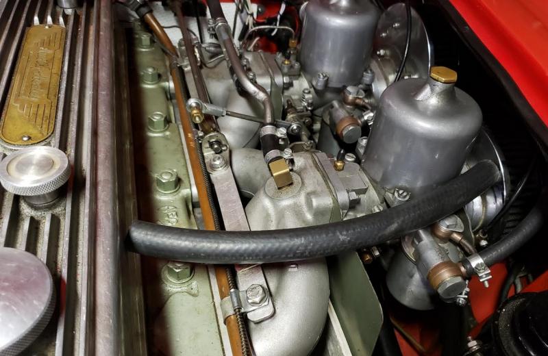

    From their testing, materials and videos, it's clear they understand exactly how PCV valves normally work (even if I don't). There's a market for their adjustable valves for hopped up engines and those like ours that never came with a PCV. Most tuners are guessing or trying out a lot of different valves. Evidently all kinds of issues can result from a PCV that flows either too much or not enough air for the individual engine.
    Our PCVs aren't normal, however. A typical non-Healey installation has a minimum 3/4" air inlet from the air cleaner to one of the valve covers. So there's a potential for a large amount of air leaning out the mixture if the PCV admits too much below the carburetor. IMO we can't have that problem because the amount of air admitted is limited by the rear main and dipstick.
    With my dual AFR gauges, I'm not seeing any bad spikes of leanness, but may think about adding one of these valves. The inline-adapter version is $149.

    Steve
    See my post and picture above. i used a "T" off the rear side tappet cover. the hole is already there. i only used the "T" so i could keep the side pipe look. you could run the filter right off the hole if you did not want to keep that side pipe.
    i also thought of getting another rear tappet cover and using it for the middle cover and just attach my filter there. then leave my side pipe alone (but plugged). i think i found the rear tappet covers were expensive. So i went with a "T".
    My thought on the venting of the valve cover. i think this probably works well on a V8 or any V type engine. you pull from one valve cover and have the filtered air come in the other. then the air moves thru the crankcase. on a straight engine (ours a straight 6) it seems the air would only move thru the upper part of the engine. that is the reason i went with the tappet cover.
    i was originally going to run the vacuum side out of the side tappet cover and let the air intake side just come from the valve cover. then i would have left my hose from the valve cover T to the rear carb and let the rear carb breather act as my filter. this set up sure looked the cleanest. but someone pointed out that i would probably pull more oil out of the engine from the side cover. good point! so i changed mine around. The valve cover also has a baffle inside to keep oil from being sucked directly out.
    i have only run a few hundred miles on my car this summer. but so far i have not had any oil to drain out of the catch can. i want to run it a bit further to be sure there is not any oil being pulled. if i don't get any oil after another year, i may eliminate my catch can and go back to connecting the PCV line direct to the front port from the valve cover T. Again just looks cleaner.

    I agree about the air intake on the valve cover being a bad idea for a straight 6. Besides, I hate to drill holes in the valve cover.
    Installing one of the little K&Ns on a bulkhead barb fitting under the alternator on the front tappet cover would be easy to do and could be plugged inconspicuously later if desired.
    I'd experiment with plugging the left side of the tee to disable the side pipe, forcing the ventilation up from the crankcase, through the head and valve cover, through the PCV and into the intake manifold.
    After Deadwood, will move forward with this.
