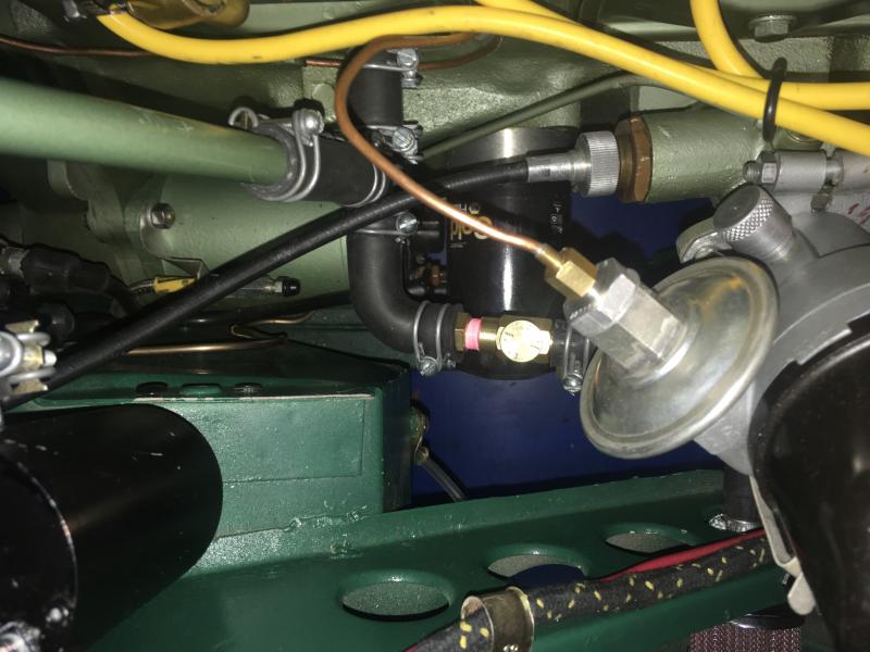

i made mine with an extra brake hose i had. i believe it was the rear flex hose. took a small piece of metal and bent it so it would hold the hose off the starter.
the only thing i had to buy was a coupling to attach a bleeder to the end of the hose. i went back and looked at my notes but could not find the one on where i bought the fitting. sorry. it was a supply house that someone on this forum posted for me. it was cheap and worked fine.
you can see the finished product at the bottom left of this pic.

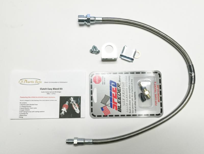

Just a comment about the kit from oldphartz. I purchase one and when I tried to use a mighty vac to bleed the cylinder I discovered the fitting that the bleeder fits into becomes loose when the bleeder is loosened and you cannot draw a vacuum. It works ok it you're pressure bleeding or pumping the clutch. Just ne aware.

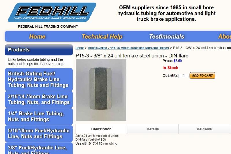

I'm pretty certain Norm Nock's book recommends against using the Mighty Vac on Healeys, though I don't remember that he provides an explanation. I have the full metal Might Vac kit, and it has not worked well on the brake system on my BN7. For that matter it wasn't the best choice for my Porsche 968, either. Further to Steve's offering of a source for a fitting that I understand will enable fitting a conventional Healey bleeder to the end of a spare flex brake line to create a remote bleeder I pose further questions since I assume Steve knows all of this. Does the flex brake line thread (24 TPI by 3/8") into the bleeder on the slave, and does the fitting pictured somehow attach to the other end of that line to take the fitting that has the capability to take a functional brake bleeder? It doesn't appear that claim is made for that fitting. Further to Steve's mention of the post I made a couple weeks ago, Clutch Pedal Went Away, I found the recommended OldPhartz bleeder was out of stock and ordered one I hoped would work from Summit Racing. I had to create my own connector to attach this bleeder at the bleed port on a new Moss clutch slave--fortunately I have the proper die and tubing to do that. But ultimately the purchased remote bleeder line seemed to leak like crazy--it has full rotational ability for the fittings at both ends of the flex line. I'm at a loss to know how that could not leak. So I'm back looking for a remote bleeder.

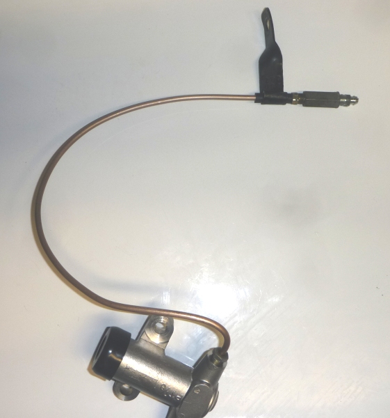

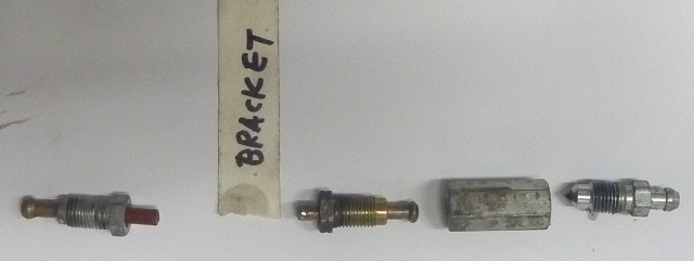

When the SS tubing work hardened and leaked, I replaced the hard line in my original Doug Reid remote:
These are the bits. The pipe is 20" with a bubble flare at each end.
This is the Federal Hill connector shown in previous posting.

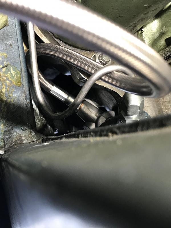

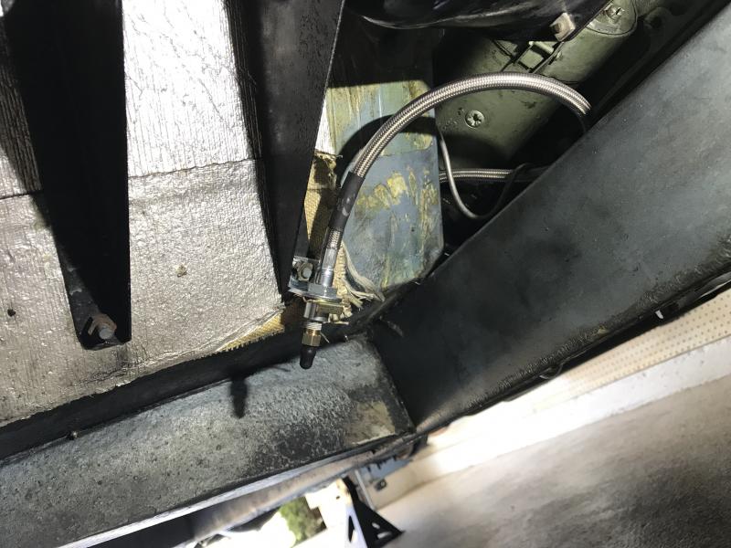

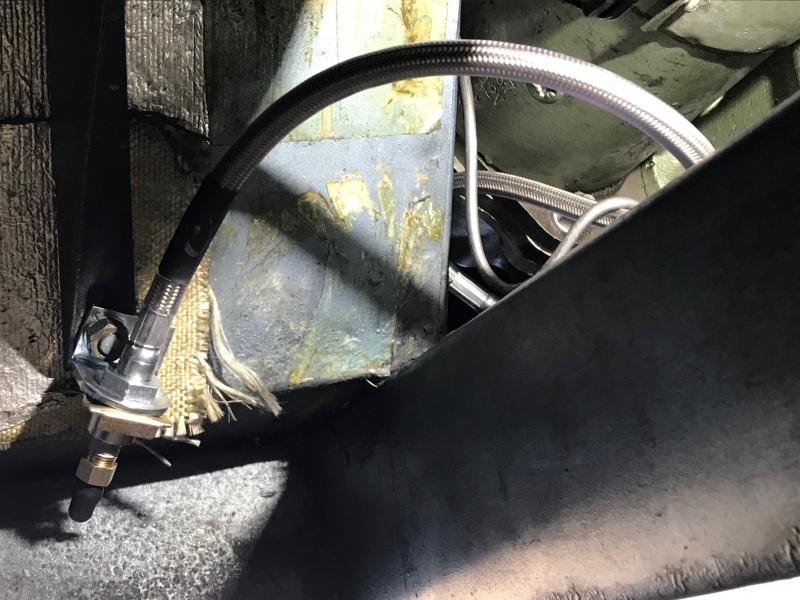

BJ8, slave to brake booster bracket. No modifications.
Here's the route I choose for installation. One end screws into slave, other end held in place by supplied L-bracket, who's hole is used for the brake booster bolt. Nice that the bleeder is facing down.
https://www.olphartz.com/hydraulic6.html
While adding the slave extension stainless hose, I also replaced the stock rubber slave hose to stainless.

Mine is an original Doug Reid bleeder - not a copy. I needed to replace the line a few years ago because the SS tubing can only be tightened a couple of times before it work hardens and starts to leak.

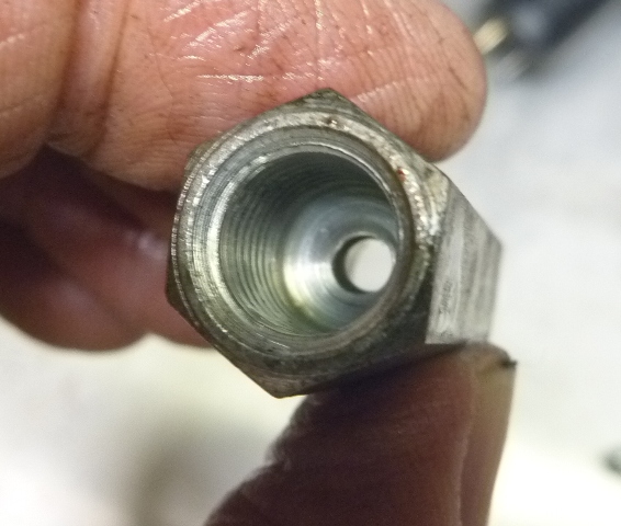

I merely searched for the coupling on FedHill in order to show how it was constructed. Anyone with a decent (Ridgid or Eastwood) flaring tool could make their own tube.
If I were adding one now, I'd use the Olphartz design because the hose is long enough to point downward as shown in the photos. IMO that will make it convenient to bleed. The Reid design requires a long hose to a bottle with the fluid.
