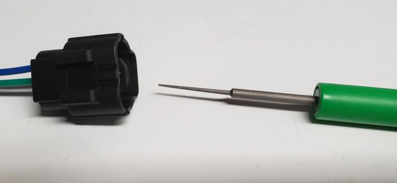

The switch functions correctly with "C" and "NC" wired. The included harness connects "NO" and "NC", so I won't be using that wiring. I've ordered a Delphi GT280 pick and am hoping I can switch the female connectors within the supplied plug; if not I'll make my own wires with metri-pack females.

I don't have any GT280 female connectors with which to make a new wire - so I need the special pick in order to move the 'NO' wire to the 'C' position. Will follow up when I find out if I can undo the internal latch with it.
I do have Delphi Metri-Pack female connectors so in the meantime I may make up a couple of wires using those with shrink tube around them. Metri-packs will slide onto the pins shown in the picture above.
